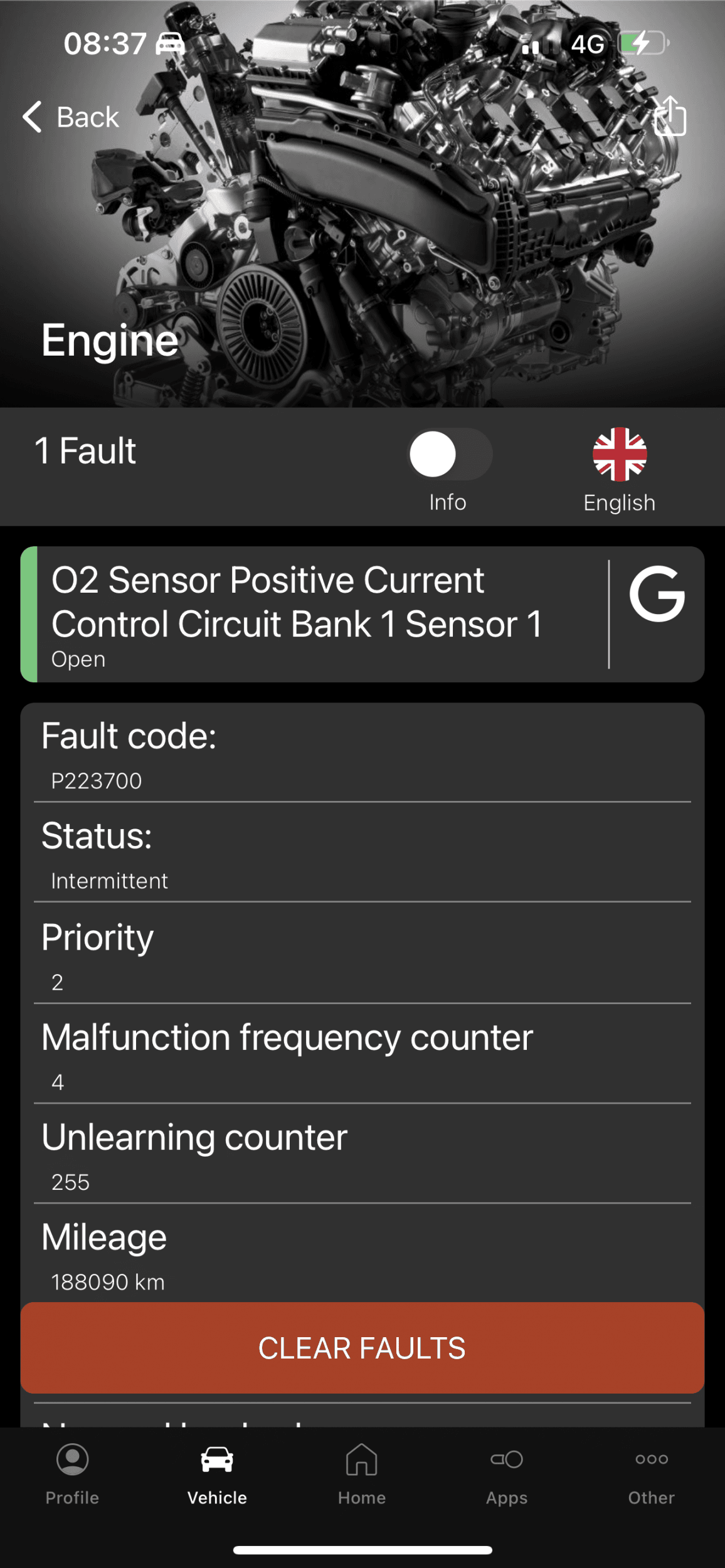

Hi guys, I’ve had an error code showing on my Leon 184
It has the EML light on.. does anyone know where this sensor is ? Is it a DIY job?

Sensor 1 is the first O2 sensor down the exhaust from the manifold, so very close to the front of the car. Ignore the Bank 1 reference as a "straight" or "inline" engine only has a cylinder head bank, ie Bank 1.
Edit:- sometimes access is tight, but you will only be able to comment on that once you have eye balled it.

had my one changed, if you do it yourself run engine first to get warm, Then use the correct socket with the side cut out to allow the socket to fit sensor. then slowly undo , if you soak it in easing fluid overnight this helps. if its the first sensor it will cost roughly £80 a Bosch one.
The second sensor is not available only at the stealers at £150. but the bank 1 normally goes wrong , mine was at 36K miles.
