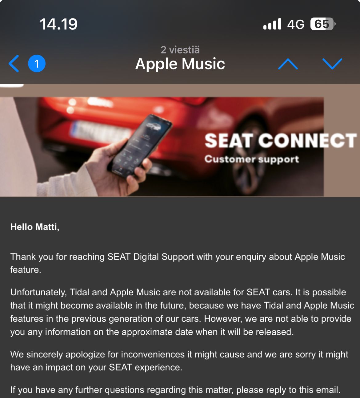

I am having this exact same problem now. I used to have online media and Apple Music in my 2021 Leon PHEV, but just noticed that after the last firmware, there is no online media option at all..
paskahata
Jul 2, 2017
19
8
Finland
Seat replied to my query. ”Unfortunately, Tidal and Apple Music are not available for SEAT cars.”..
Eh.. I am a bit confused. They both were available (and working) before the update. And both of them are found in the list of Connect features? Haha. Way to go Seat! 😆
