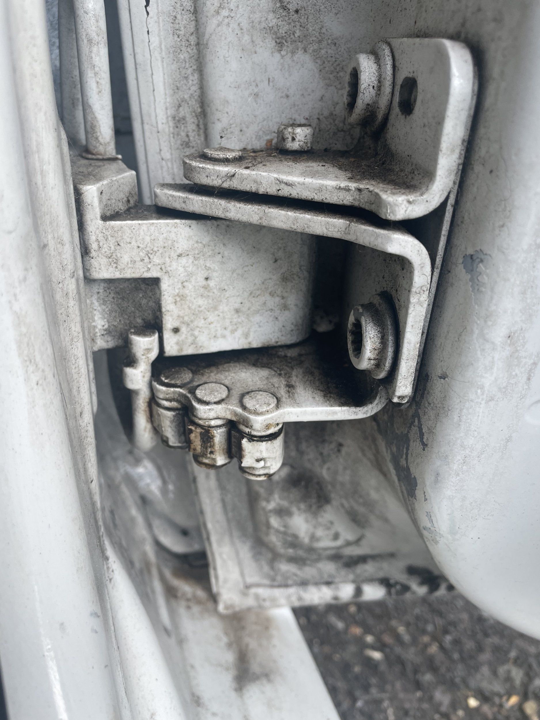

Hi mate does that door line up the same as the drivers door gaps? It might be tweaked at the hinges from the crash and not straight putting more stress in the hinge and causing it to run metal on metal. Can you send a photo of the hinges?

Hi I have attached a pic

Hi are you the one who repaired the door? It was it done before the car was sold to you? Doesn’t look as bad as I was expecting mate. Tuff one without being there in person to help. If spray grease didn’t help I’m out of ideas now sorry.
You did spray all context surfaces didn’t you? From the 3 stoppers at the bottom including the bar they use and the pivot points of the door especially inbetween the gaps of the bracket to the pin that holds the hinge together?

Thank you, I tried silicone spray but no use, would you recommend anything more? It seems to crack on each stopper

White lithium grease. Try a spray as it's easier but a tube/tub should be more effective although harder to apply.
On my older car it had white lithium on it but I freshened it up with a can of silicone spray and it actually created a squeak/creak.

To be honest that’s what I would have used too mate. Is there anyway you can slightly bend the bar that locks into the 3 little door stop parts so it has less force pushing it if that makes sense? Also maybe wire brush off the 3 stoppers so they are bare metal and then reuse your grease to stop it rusting etc. it’s a tuff one as normal they aren’t noisy but grease will stop if they do get noisey. That’s why I think something is misaligned buddy.
