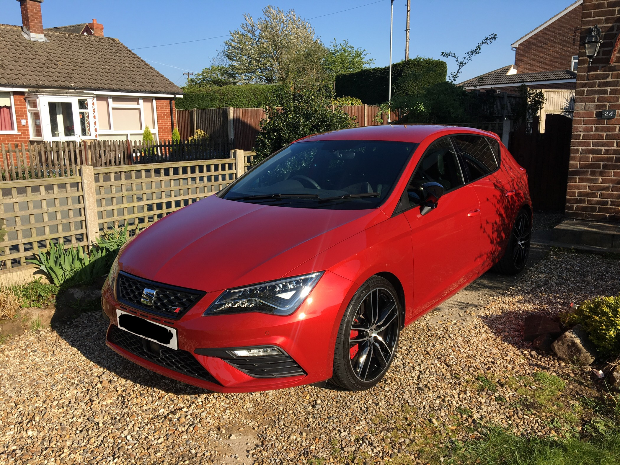

Would really appreciate some advice on protecting my new car paint and alloys.
Picked up my Leon ST in desire red today.
I priced the csl from techniq and they want 800 euro to apply. This was beyond my already streached budget so looking at doing as much as I can at home.
Read the pdf guide on detailing and sticking to my original plan for the moment.
1) Full car wash, auto glym with wool and microfibre mitts. I also have a karcher k4 but not sure if this is advised to use at this stage.
2) light hand polish with Meguiar’s G17216EU Ultimate Compound Colour & Clarity Restorer.
3) apply Sonax cc36 pre treatment, base and gloss coats.
Any advice on how good or bad this plan is and any suggestions would be great.
Thanks

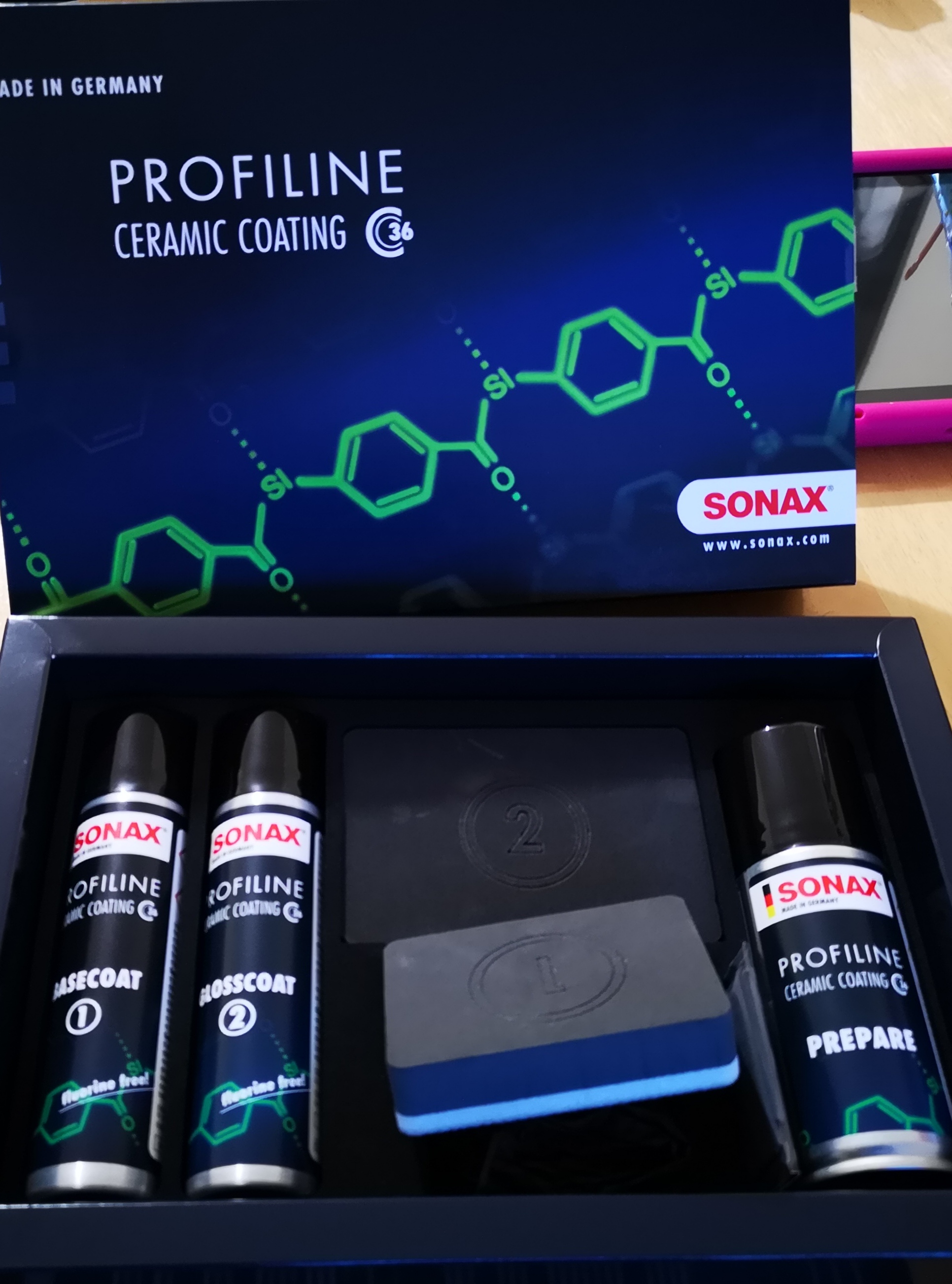

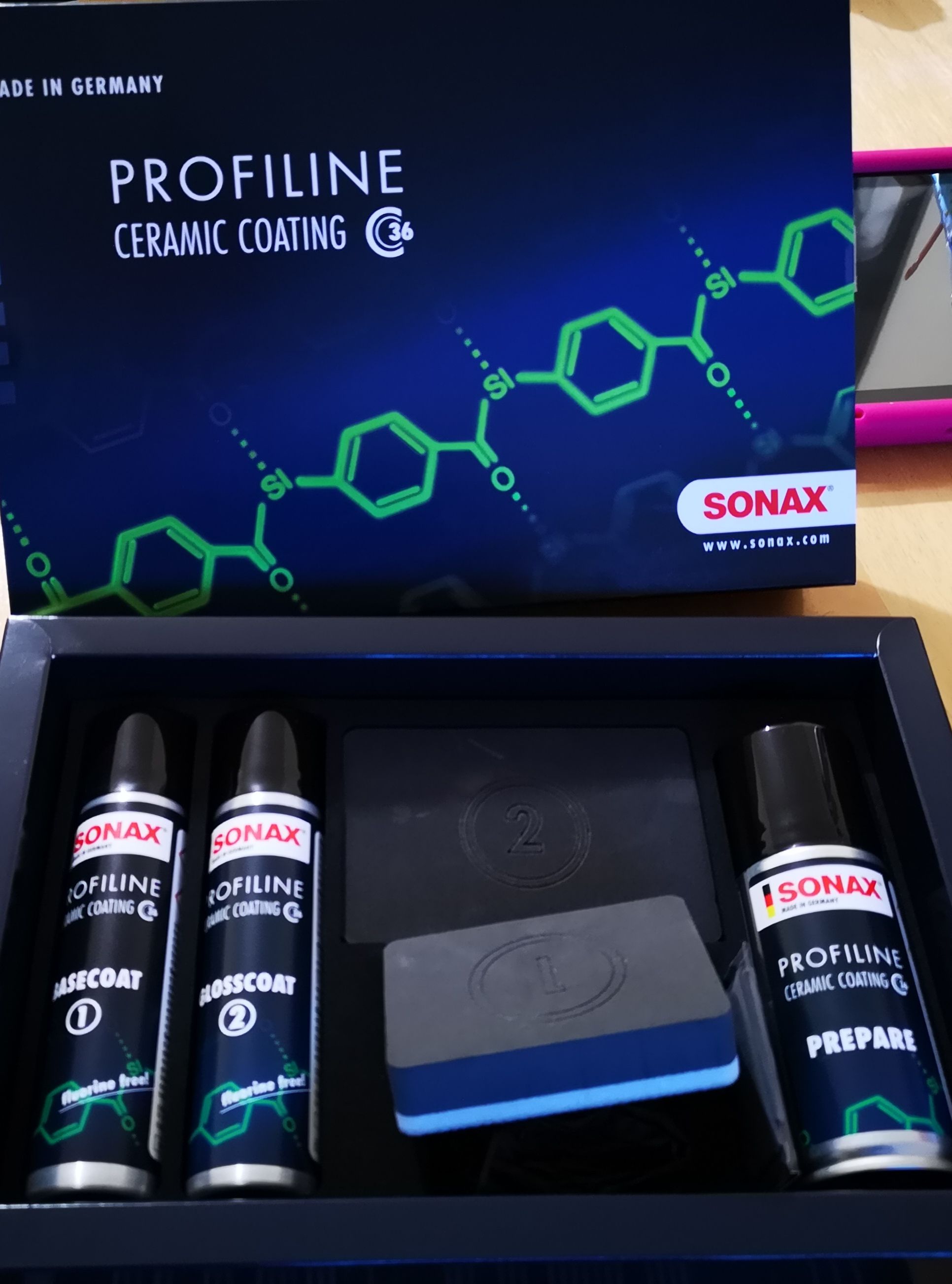

Okay the sonax cc36 has arrived today.
Car is 1 week old and paint, to my untrained eyes, looks pretty good to be honest.
At this stage I thinking of just a snow foam soak, standard shampoo wash and then onto the sonax prep, base coat and gloss.
It seems the claying and polish are not recommended on new car, unless there is a reason to use them.
The citrus and iron clean not planning at the moment.
Tar removal, again not planning unless there is visable tar to be seen.
What's the worst that can happen :whistle:
It will ware off in a year anyway if for some reason anything get trapped underneat. Will just ensure each panel it closely inspected before applying.
It will be better than the last car got washed about twice a year:runaway:
