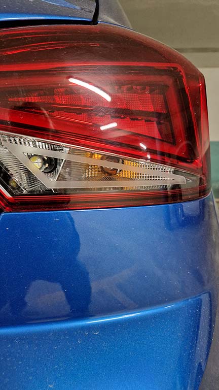

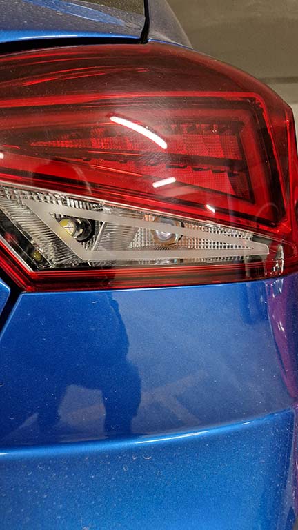

First thing I did was to change the rear turnsignal lamp. Allways hated that yellow look. I bought the Osram Diadem Chrome P21W. A little bit better. I also the opportunity to change the backlight to a LED ive got from Amazon, Aglint W16W LED, works ok but had to change it to a LED lamb in obdeleven otherwise it showed an error.
