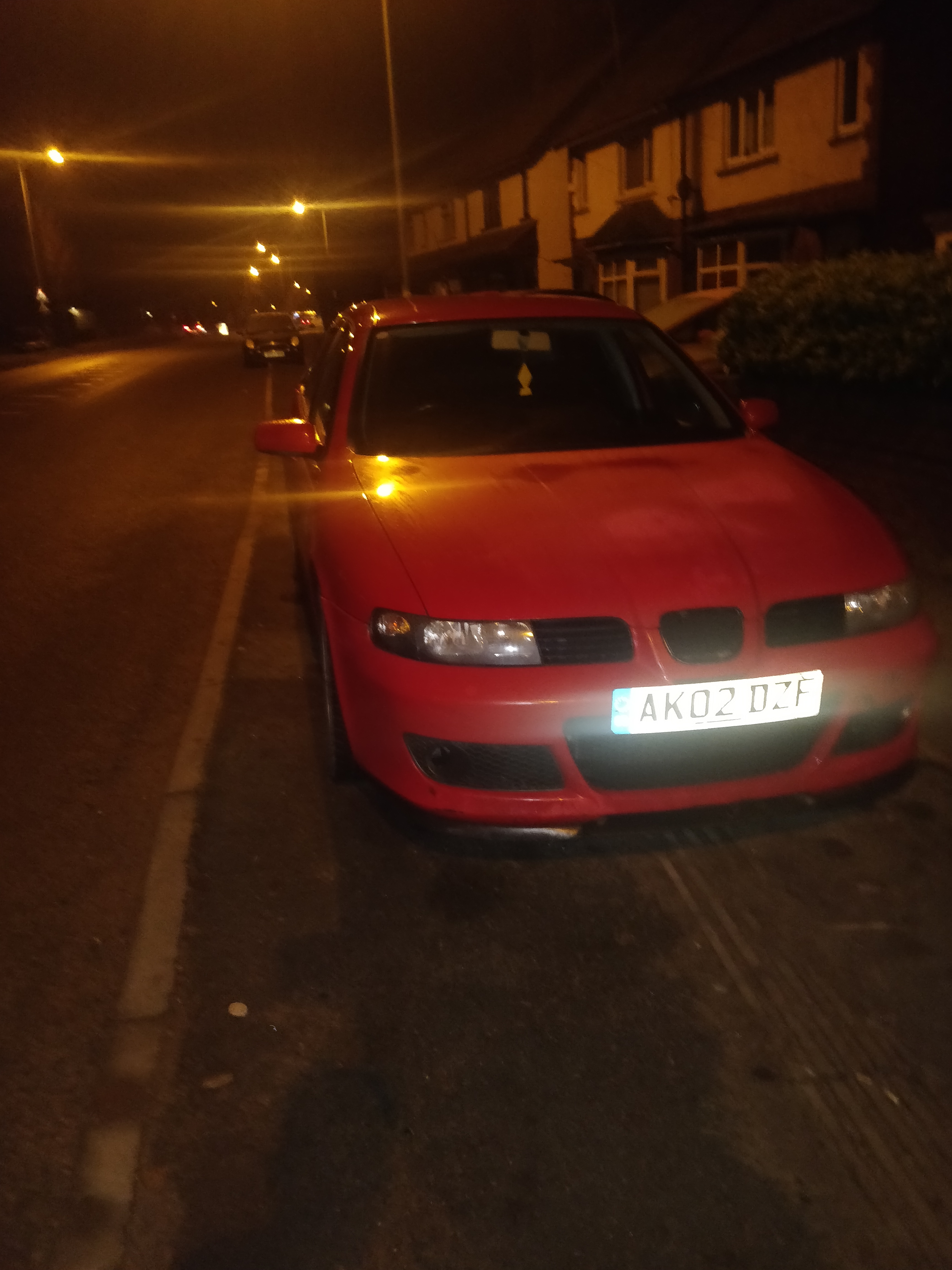

Anyway, here's a few pictures so far!
This is how she stands at the moment with her new bumper on :)
Painted the door handles as they'd faded past pink into a white
