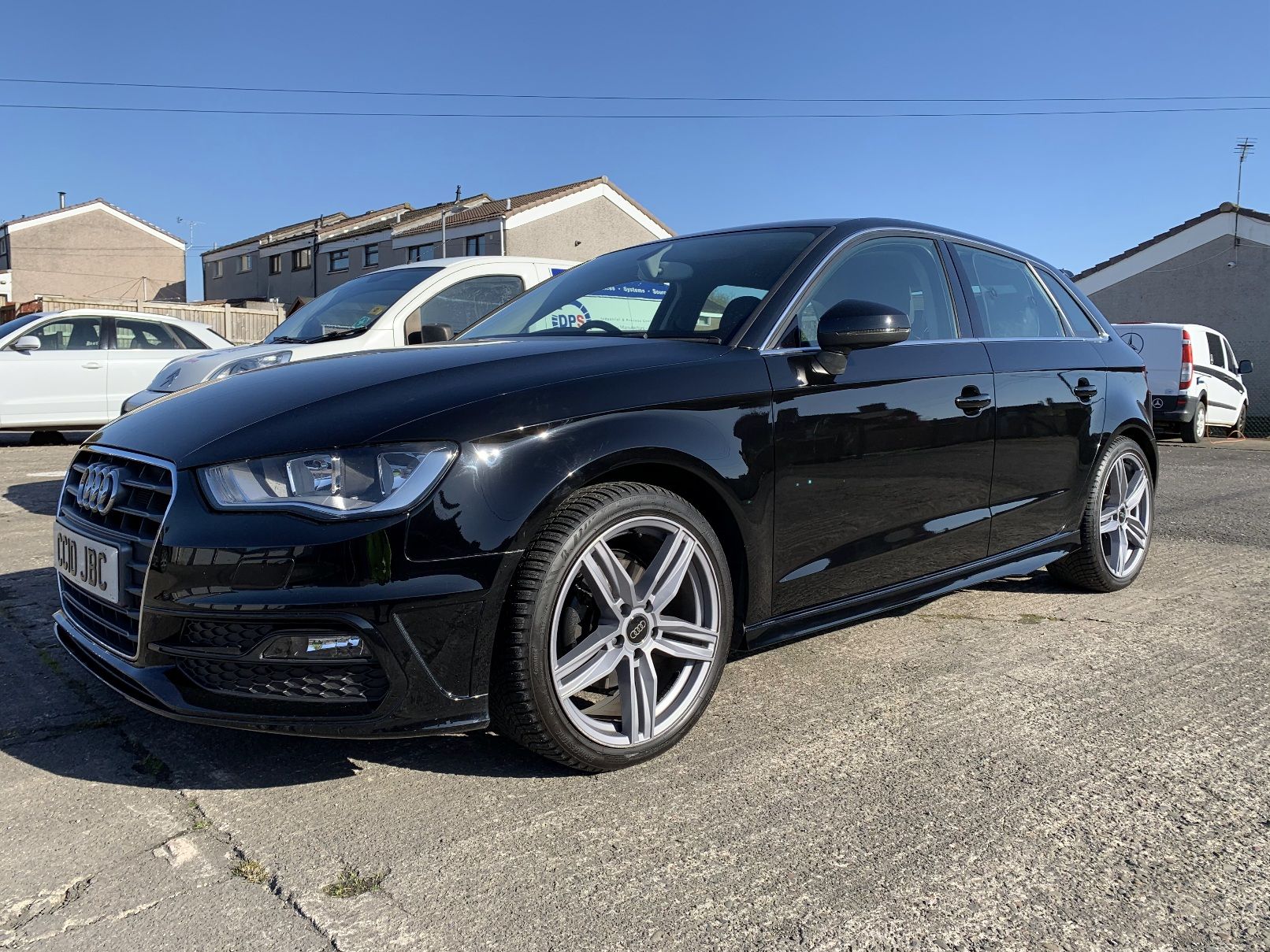

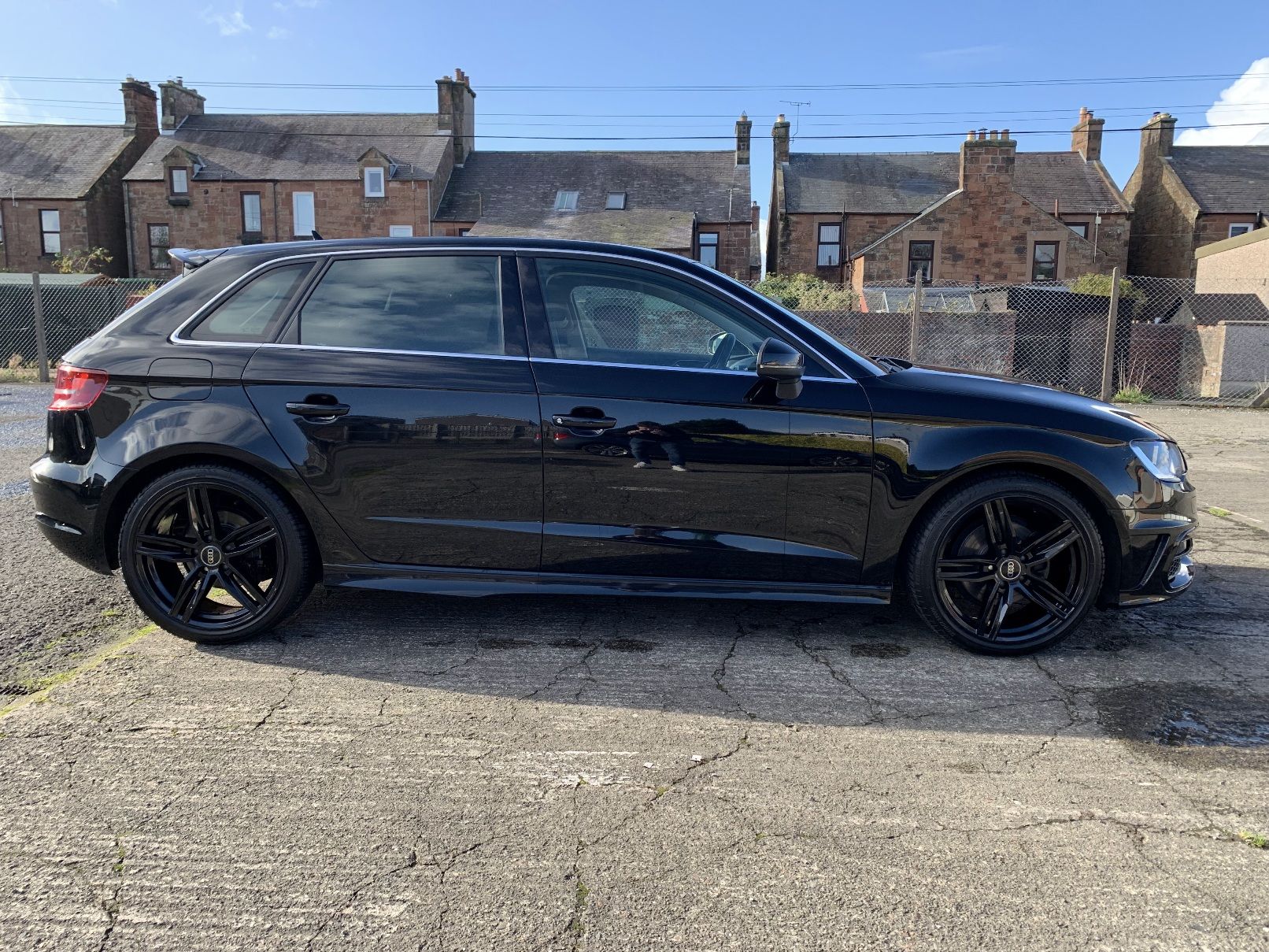

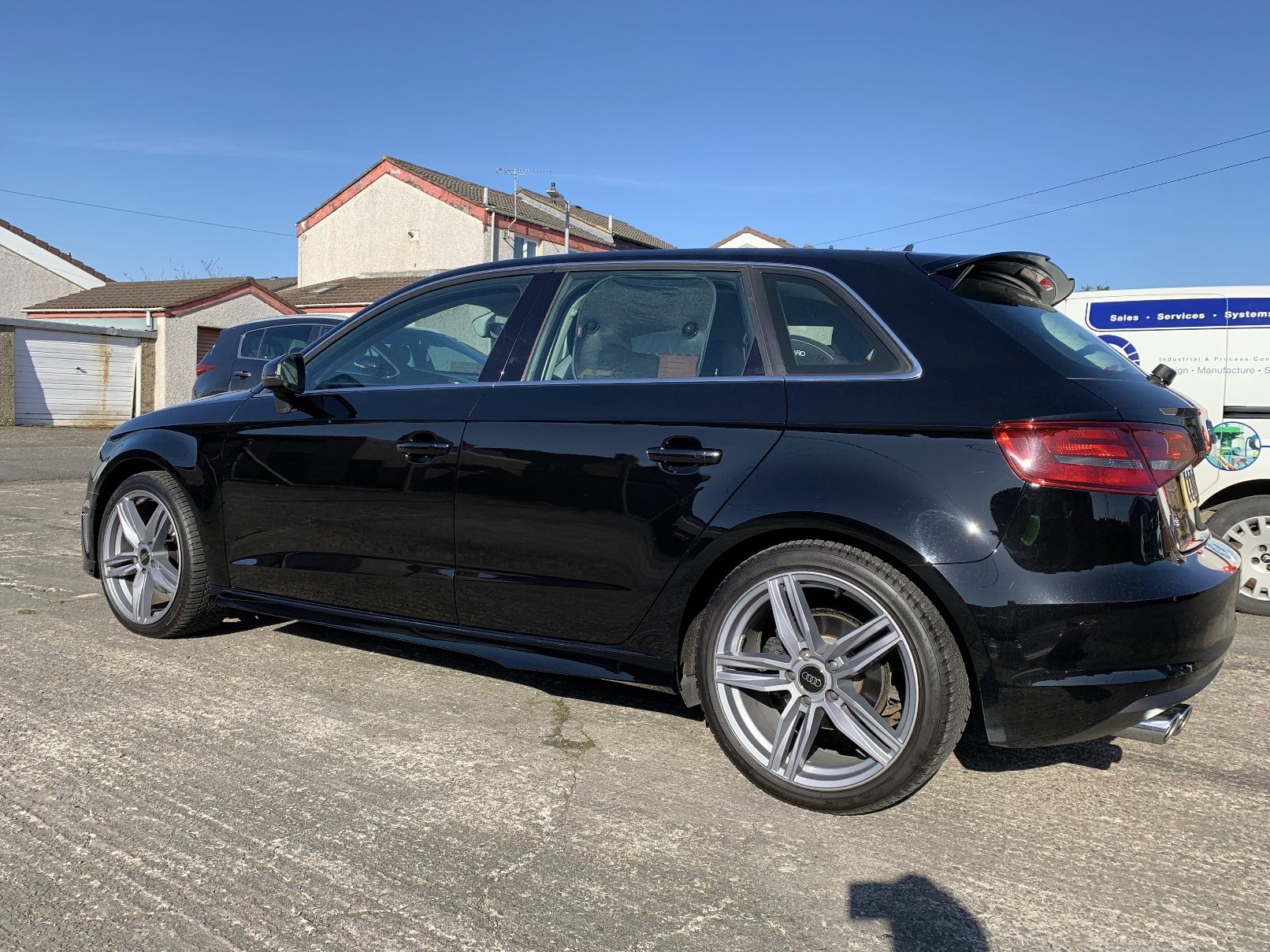

Romac Venoms are sound.
18" 8J wide with 225/40/18 or 235/40/18. They come in ET45 which is perfect fitment.
I had that setup on an Audi A3 which is the exact same as a Leon

235/40/18 rather than 225 will cause your speedo to under read slightly..
Will probably bring the speedo more accurate and true to actual speed as all cars are manufactured to read on the safe side with regards to true mph reading.

Thank you both. BigJase88, was it 225's you ran with on your Audi? That seems to be the standard size for 18 inch leon alloys but they are a 7.5 wide wheel with ET51.
