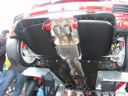

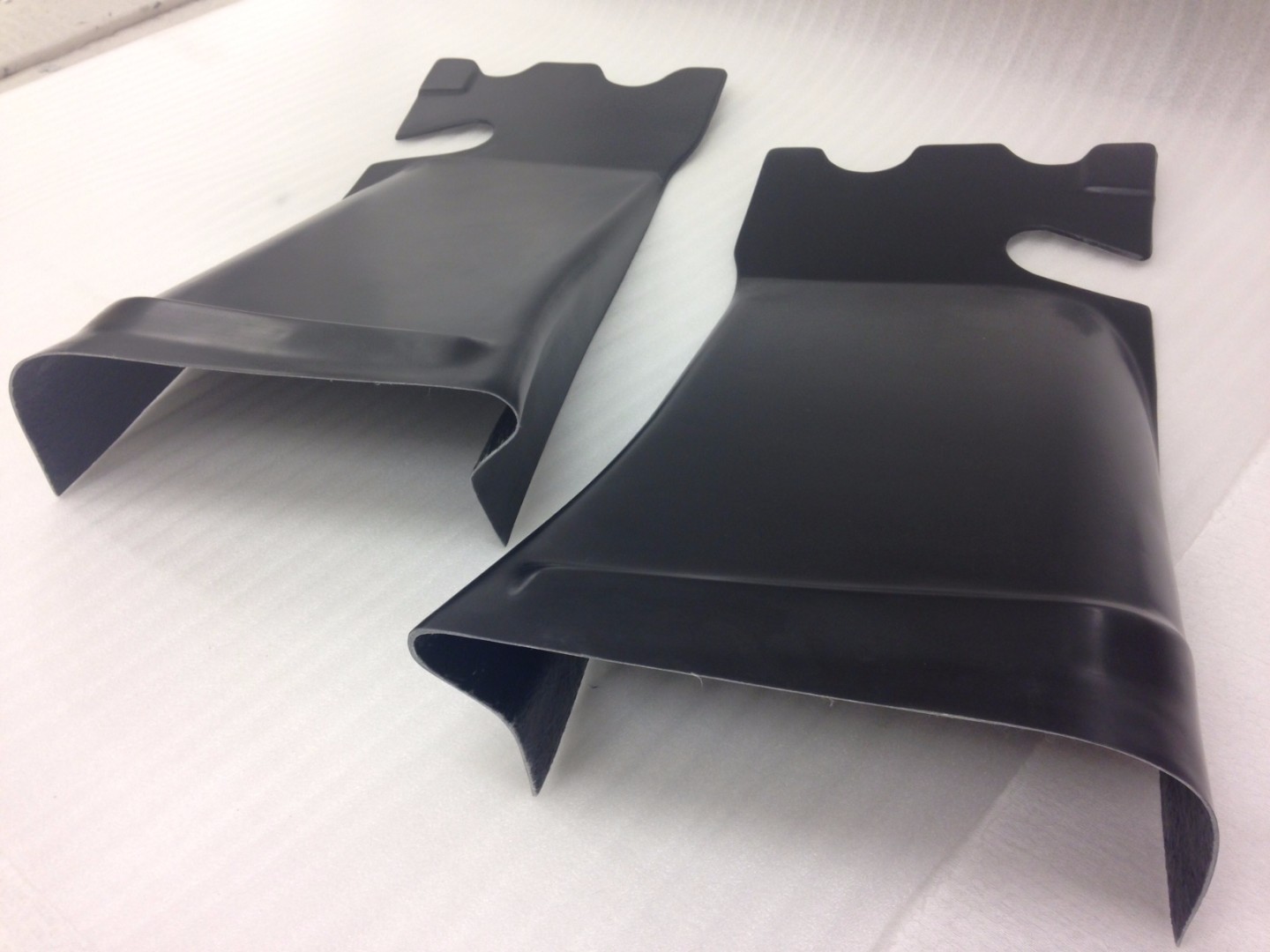

To get a big improvement that you’d notice:
You’d want a smooth under-tray from the front to the back. This could then link into a front splitter and a proper diffuser. A proper diffuser should start at least from the rear axle on these cars, not just be a trim for the lower part of the bumper.
Think something like this...
You can see how it starts much further forward and the space from what would be the ground gets larger. This makes the air less dense, sucking the car down at the rear.

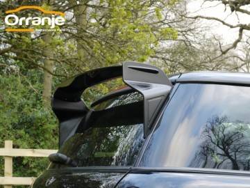

Rear Spoiler wise you’d need a proper decent rear wing. There is a guy on Facebook who has one but now I’m looking for it I can’t find a picture. It was at Trax the other day. I think @Syphon snapped a few pics of it.
No doubt helps a lot but it’s not my cup of tea. (Anyone who says a rear wing on a front wheel drive car is useless does not know ****)
Sorry for the mini photos but if I was going for a wing that created downforce, I’d compromise from a full on racing car one to something a little more road car sized like this...

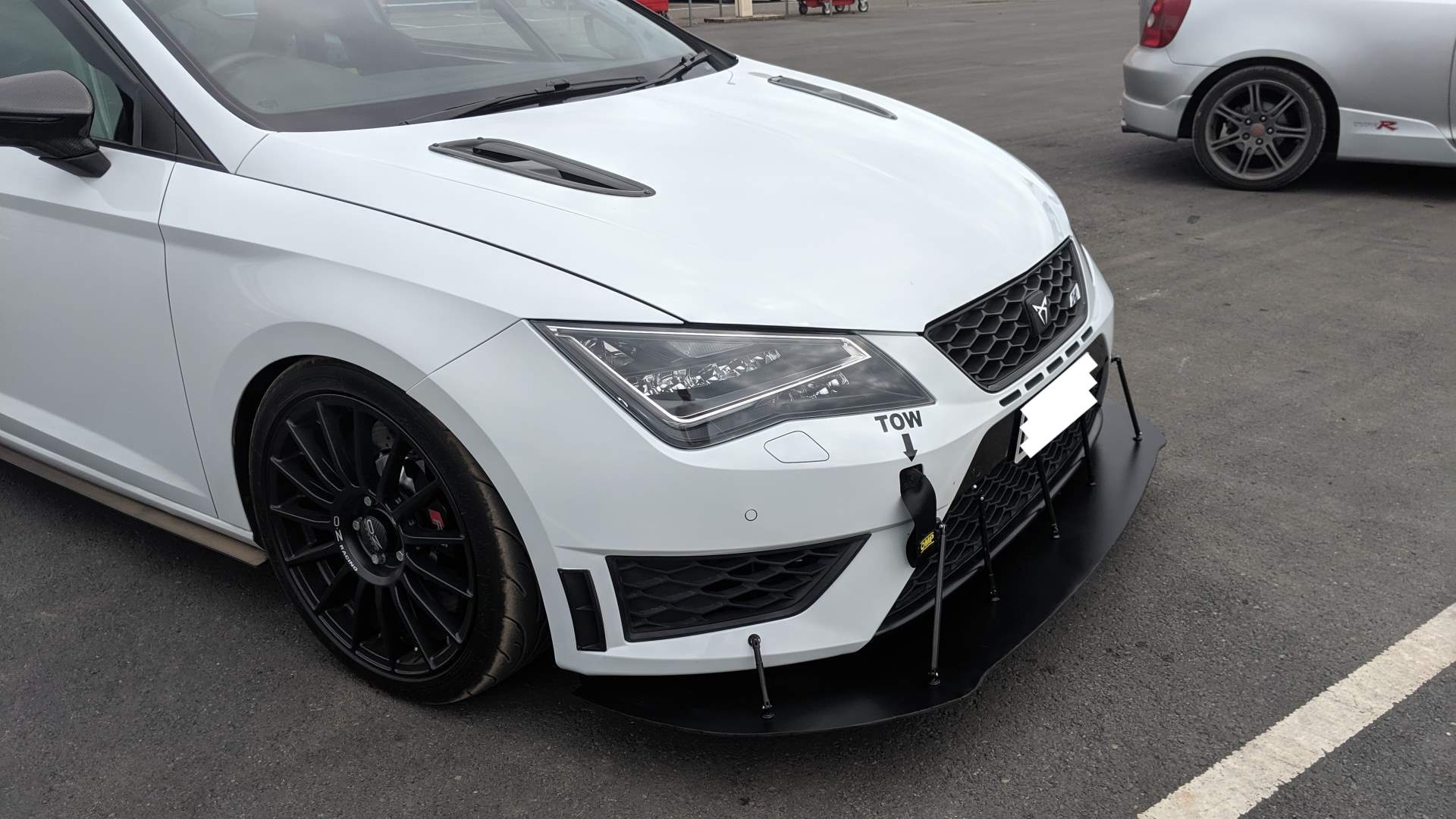

Is it this one, I have seen a few guys with these big rear wings.
and this is his front spoiler
