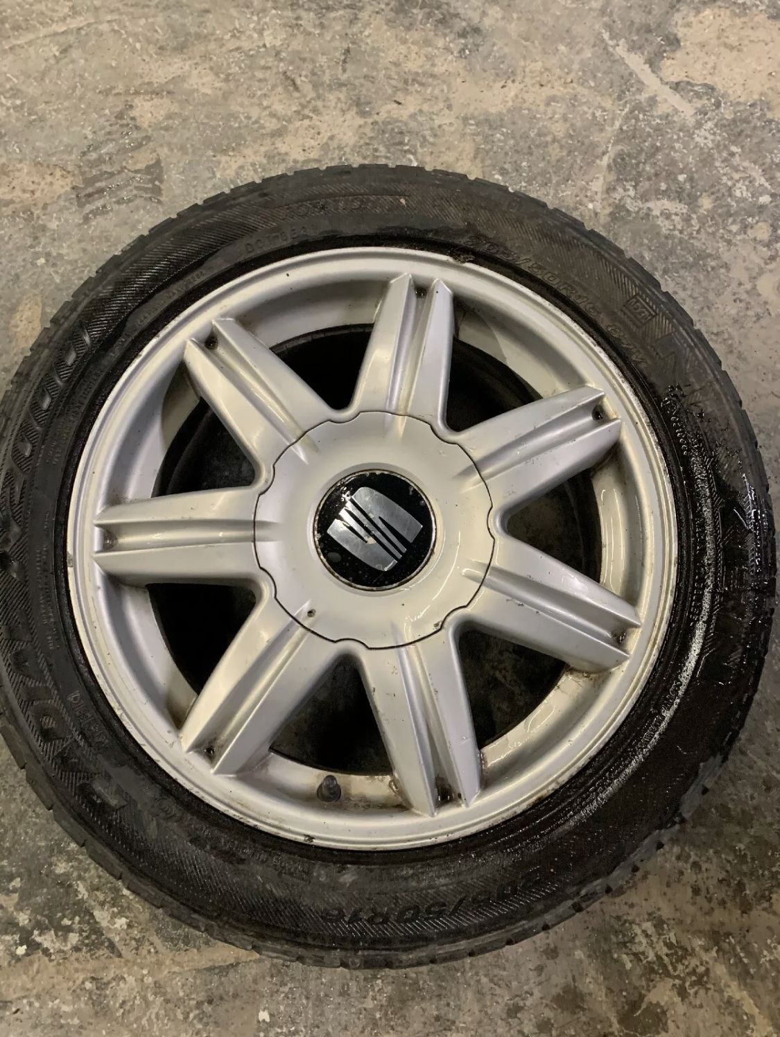

I have a 2003 PD130 Sport with 288x25 brakes & the 16” Seat sport alloys.
To go to a 312mm setup can I just use 312x25discs & 312 carriers (Octavia VRS or mk1 TT) retaining the existing 288 calipers & pads?
