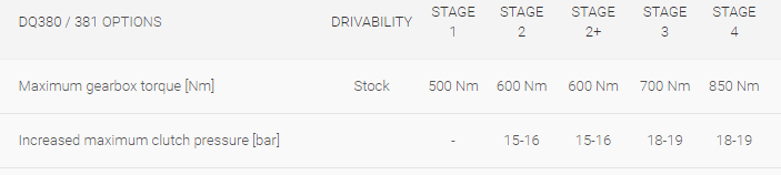

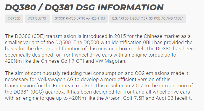

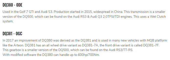

SuperV8
May 30, 2019
1,544
685
From darkside developments:
From TVS:
Reactions: Mo_86
