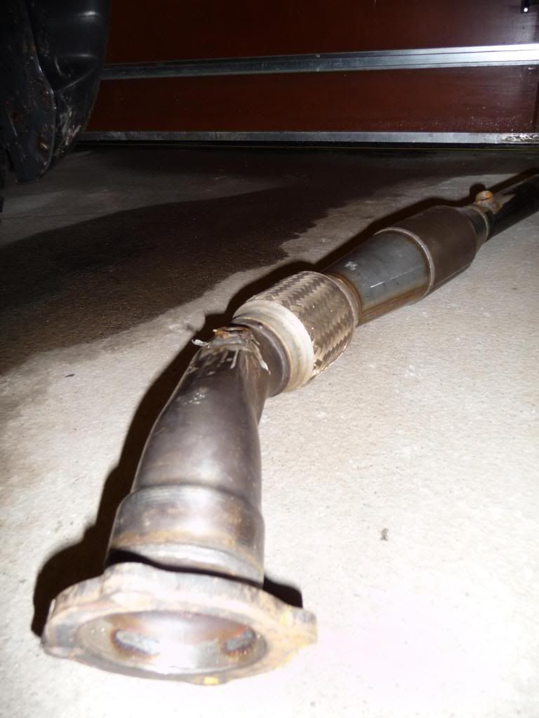

Dear all,
Anyone got a pic of their milltek downpipe and cat MSVW257? I just bought a second hand one and when I got it there is a very flat area just in front of the 1st lambda sensor area around a foot from the manifold end. Is this normal and is it just to miss the bulkhead as it curls down to the exhaust area.
Thanks for any help as I have booked it into a garage tomorrow for fitting and am wondering if this has come off a crashed car or something.

Hi Lee,
I saw that pic before, it does look a bit like that, just above the 6 in junction26m1 and straight across from the gasket. Hope that gasket is not different from a standard one also and the clamp on the standard exhaust is the same for the other end or thats another problem.
Took a few pics have to say it does look like its been flattened by a machine there are kind of claw marks like vise grips but 4 or 5 " vise grips and I don't think its been hammered. See what you think
http://i1232.photobucket.com/albums/ff379/davidhunter72/milltek.jpg

I've also got one (that i bought second hand) but it also has the same flat area so i'd say its done by milltek. Its unreal the difference in size when you take the old one off!!
