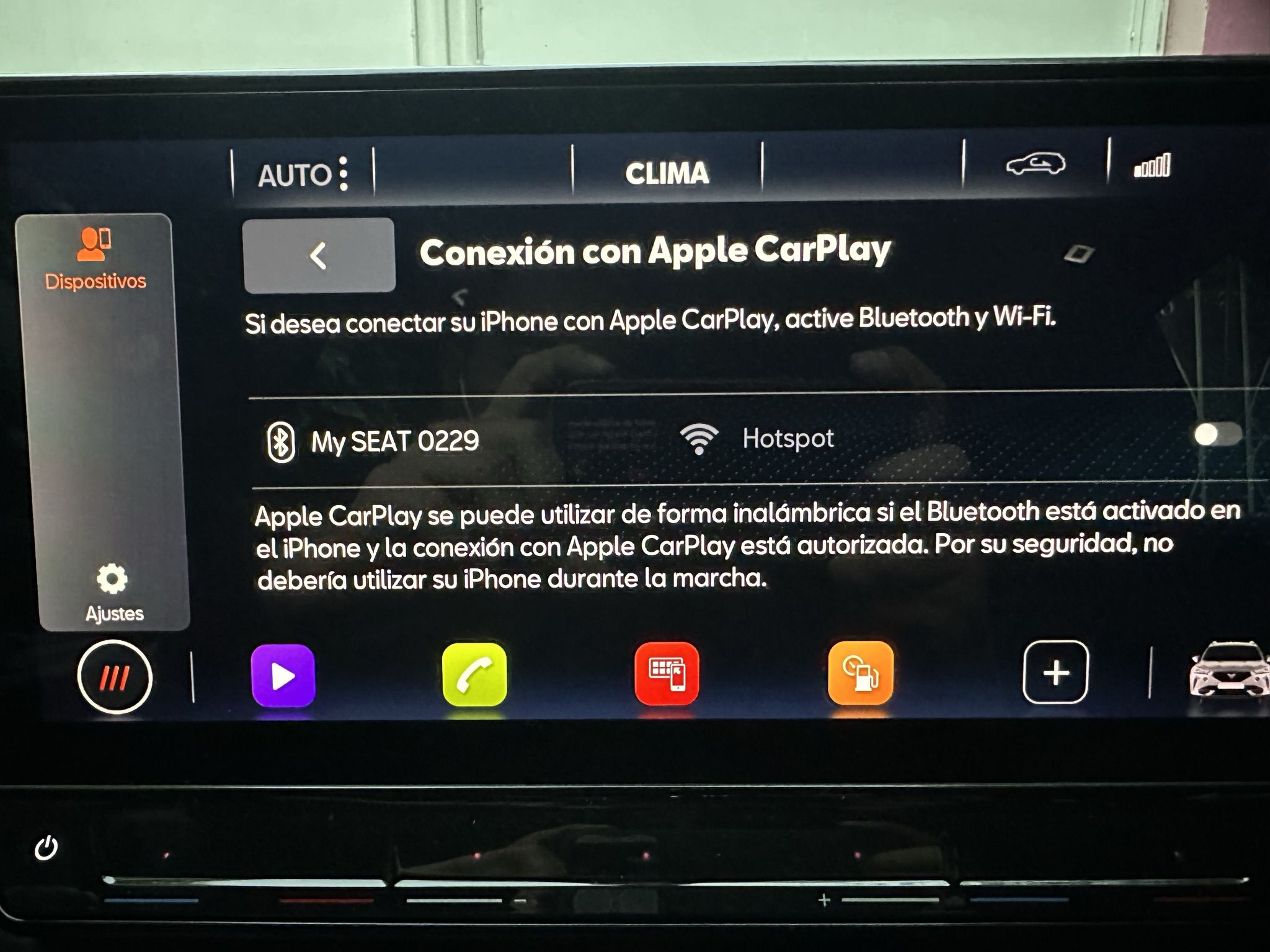

Hello everyone!
I was wondering if it was possible to unlock the wireless AA on my unit when I found this forum!
As far I could understand, it might be possible using the Obdeleven, but before buying I wanted to ensure that indeed is possible. I've got a screenshot of my software/hardware version and VIN number.
Is there a way to verify this?
Thank you!
Tell
Full Member
You got the H56 hardware as covered in the OP so on face value it would work. It's probably a suck it and see. It will be something picked up on user groups and passed on here. There is a twist that you also may need to do with some phones to force them to go into AAW mode. You read that on boards. So you can check whether you have one of those with a Google.

It's not that simple frustratingly. If the car doesn't have the telematics module, it can't have wireless Full link (true for MQBevo, MQB doesn’t necessarily require separate OCU)
Tell
Full Member
Why it's suck it and see. Worked for everyone on here so far.
Can you check their VIN if they gave it to you and see whether it's got it. I'd find a use for Obdeleven in anycase but I guess if people are tight with the £ / €.
SE37x vehicles are pretty much good to go. SE38X requires that the vehicle has a telematics module (OCU)
