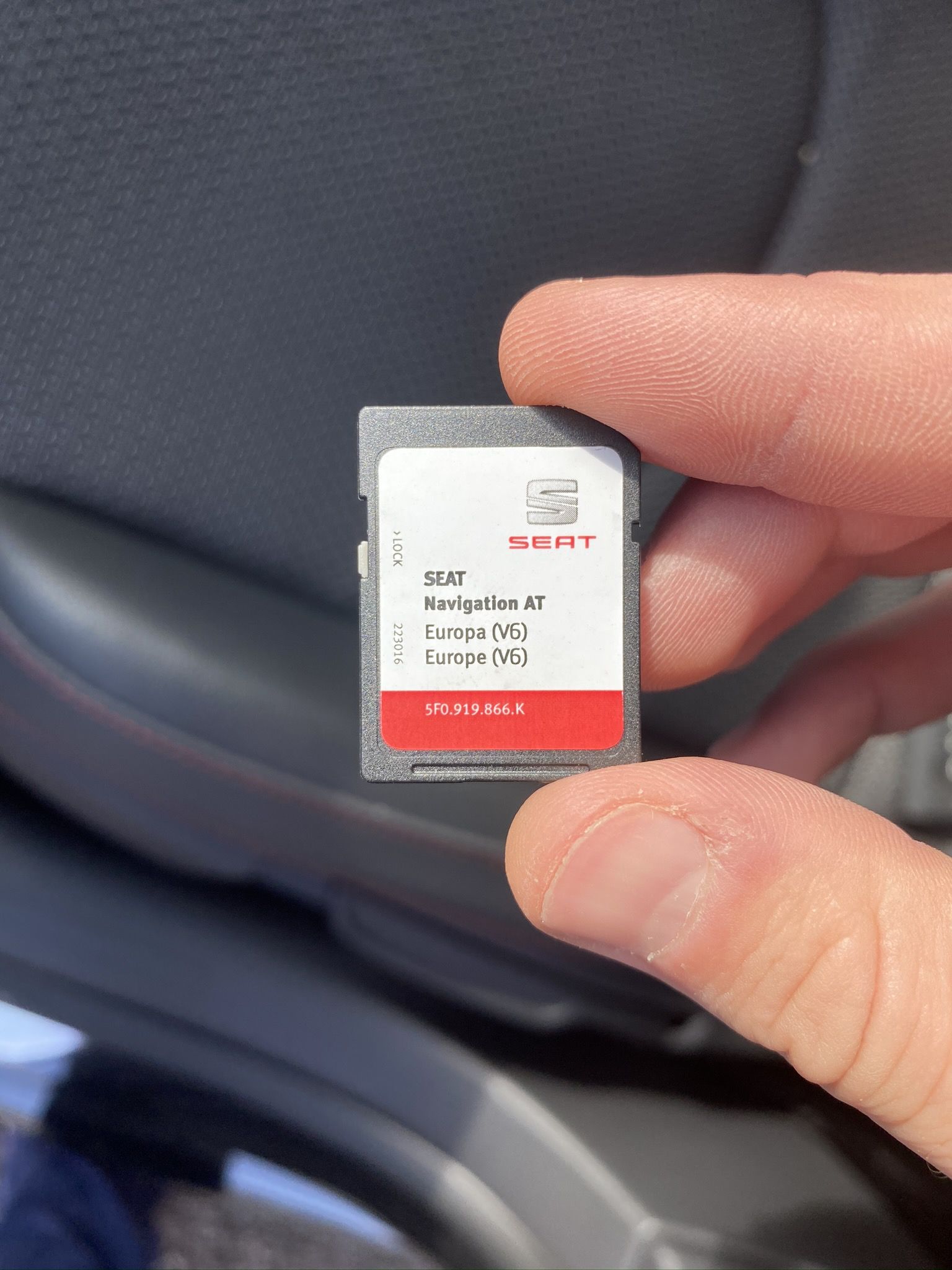

The original SD card is labelled 'SEAT Navigation AT Europa (V6) 5F0.919.866.K'
Is there any way of updating the maps without going through the dealer?

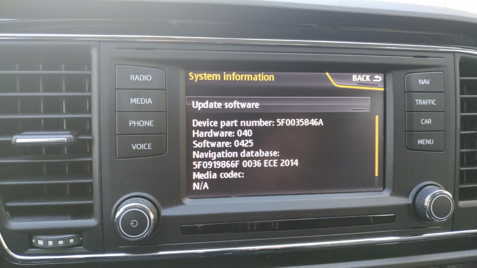

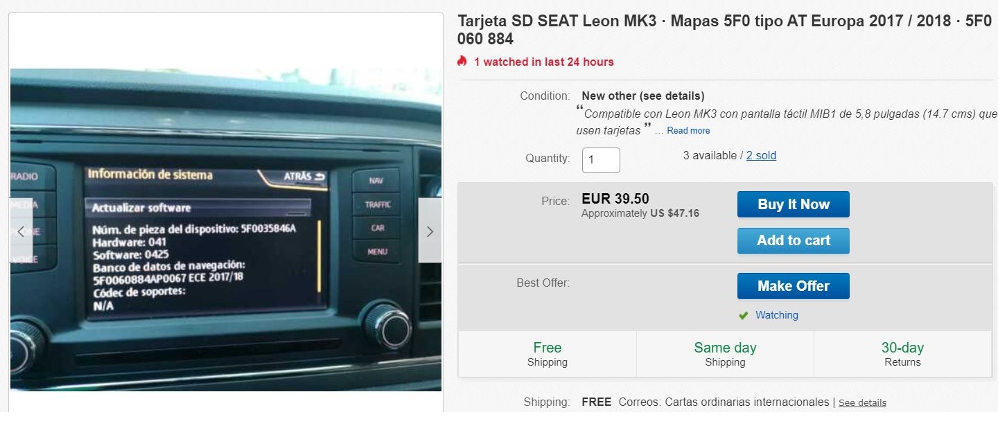

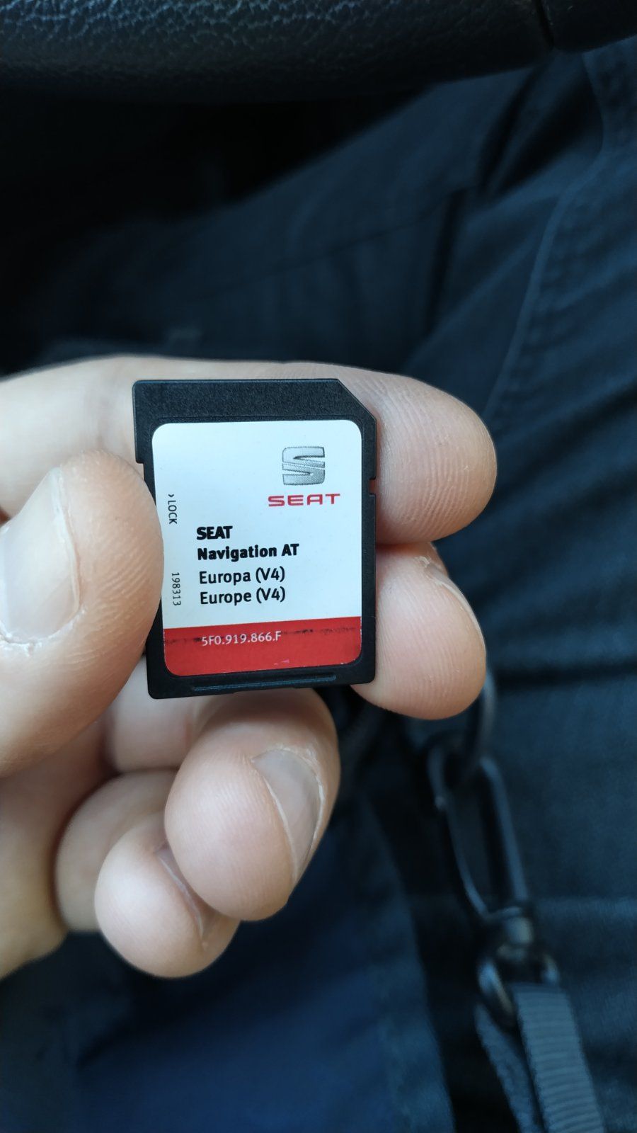

Hi, there! I am wondering if I buy a navigation SD card (newer than mine) by e-bay would be any bad issues with it? I mean could my SW and HW versions be compatible with new SD card and do I need some kind of activation or something like that to use it? See attached files please, the first two are what I have now, and the third picture is what I am thinking to buy.

It has to be activated for mib1. There are no DIY workaround that I know about unlike mib2 standard.
There is a long navigation thread which started of with mib1 then moved onto mib2 as time wrnt by but no fixes for updating the maps. 2020 is the last year of VW map updates for mib1, that's 5 years on from when VAG switched to mib2. Now they are on to mib3.
All of the VAG cards whether mib1 or mib2 have compatible CIDs on the card. For where mib1 people buy a car secondhand without an SD card you can buy any card and if you find the download of the map files put that back on the unit. If you loose a file(s) and someone gives you that historic release you can write that to the card, but you can't update the cars registration of the year / period of the card to the car yourself. That's about the only DIY thing you can do with the unit yourself. Mib1 maps were still being updated till 2020 since mapcare for life not sold on Seat cars until 2019 or so on Cupra's in the Netherlands is the only instances and that was on mib2.
