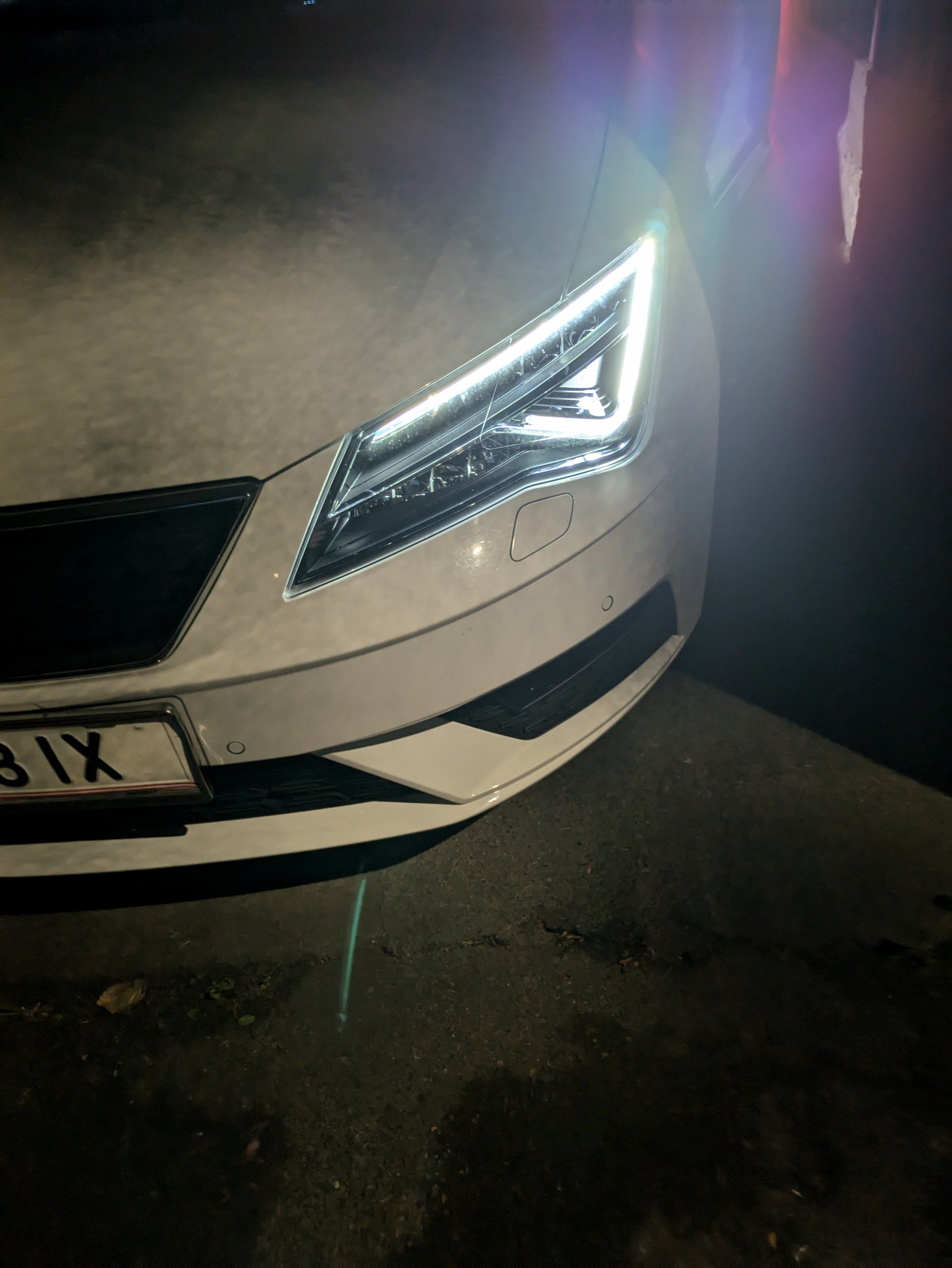

I've seen a few VW group cars including one mk3 leon with drls on while parked.
How is this enabled and does it not drain the battery?

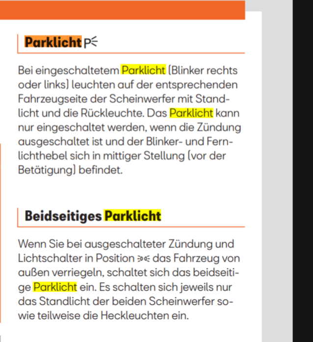

what I have in mind is the daytime running light which is also the parking light
