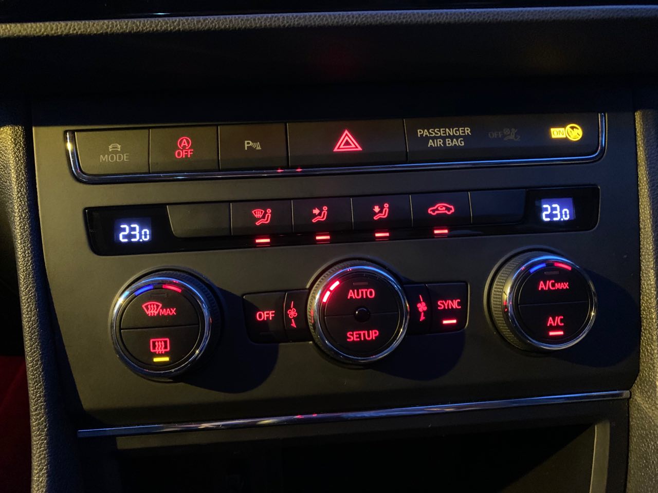

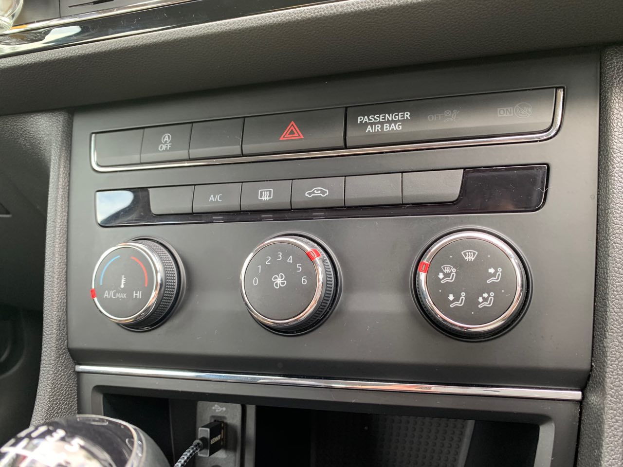

Today I replaced my dumb manual climate control with the automatic one. Took about 30 minutes to install, change some pins and do the VCDS stuff. Of course it's not a dual zone climate, because retrofitting dual zone would be a real mess and also would cost a lot as you need to change almost everything related to climate under the dashboard.
I am pretty happy with my accomplishment as it was my first retrofit experience. Next in list for my Style Leon is Seat Sound, 8 inch screen and maybe virtual cockpit.
If anyone will be interested, I can prepare some instructions. Cost me 30 GBP.

Looks better! (i note the additional mode and sensor buttons! - guessing these dont work...)

It could be retrofited as well. You just need an additional cable and few minutes in VCDS. But I dont really need those buttons as I dont have a front parking sensors and driving modes are not really useful for 1.6 tdi.
