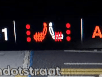

the passenger seat has seat heating, but it seems to go on and off sometimes. Unlike the driver's seat that simply stays on.
Does anyone know why and whether you can just leave it on?
I also read something about smart seat heating, but can't find it
Thank you in advance!

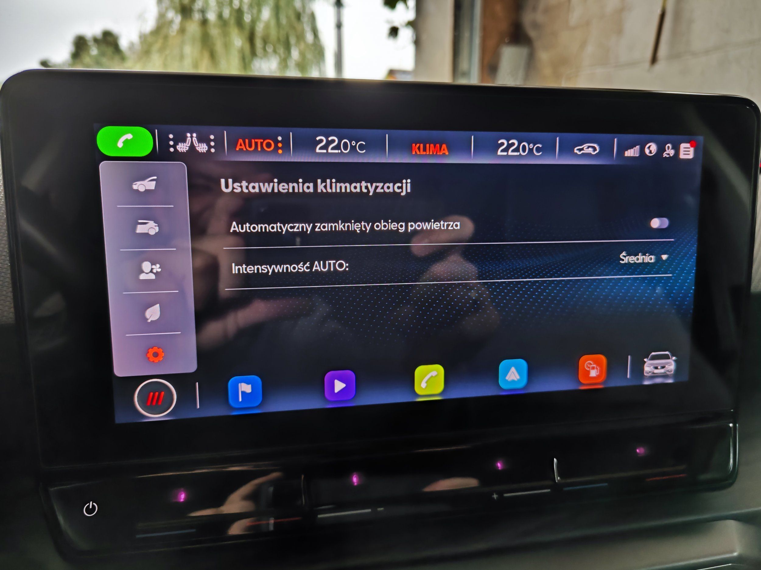

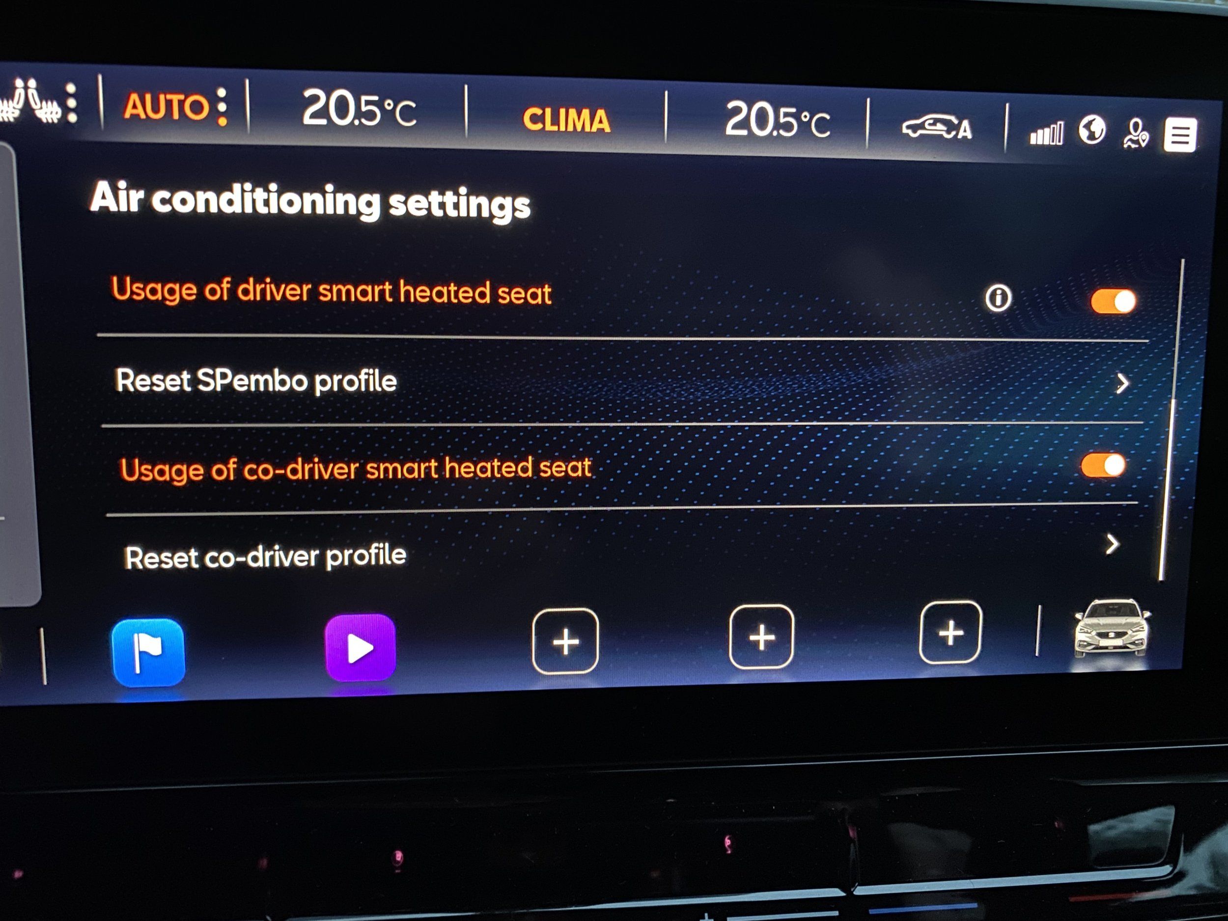

The smart heating goes through a learning process to learn how the driver and passenger use the seat heater. There is a reset for driver and passenger somewhere in the settings or probably within iclimate settings. You can also turn it off completely so its manual on/off only.
Where ? I dont see this in options
I want say in iclimate setting, but without being in my car I can’t be 100%

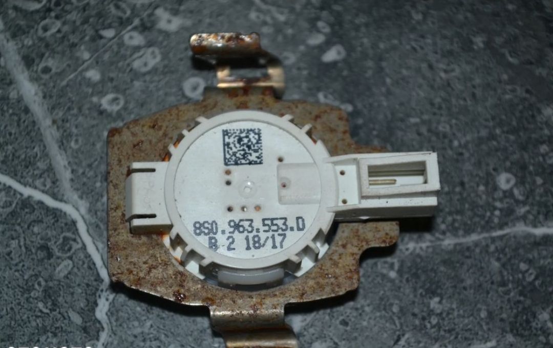

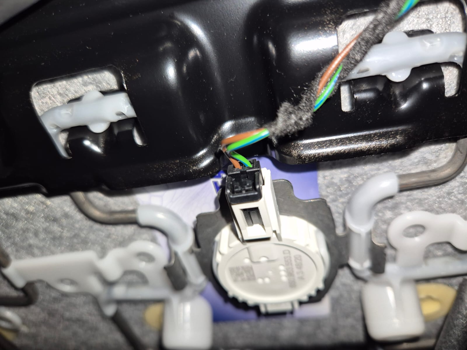

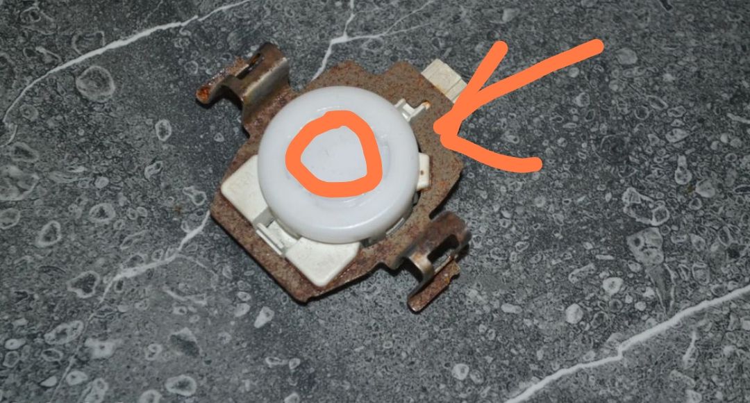

you can do it yourself. very simple. you don't have to disassemble anything. you put the seat all the way up and look under it. somewhere in the middle there is a sensor. you put something between the sensor and the sponge about 1.5 cm and about 1 mm thick. you have to make the thickness by trial and error because if you put it too thick it will constantly detect the passenger.
This sensor is under seat

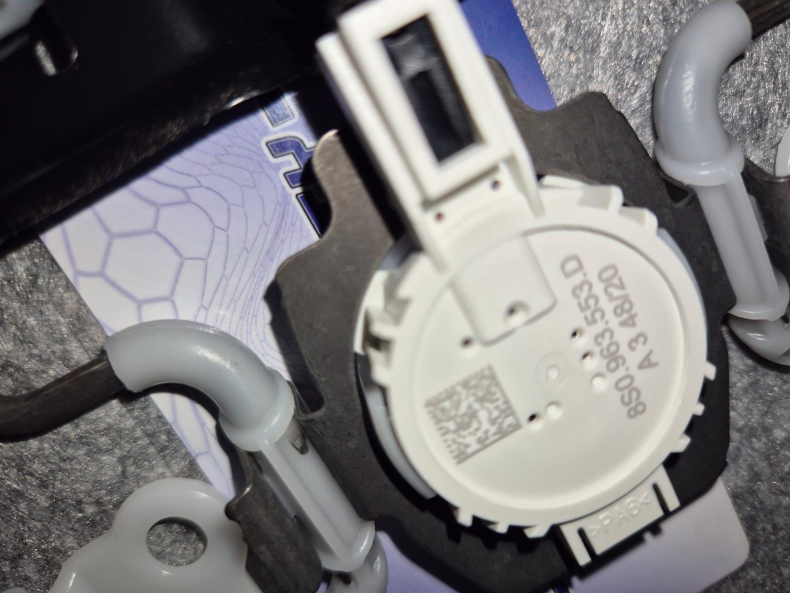

Thank you @witek_77, i put an old card between the sensor and the seat, and after many weeks of tests i can finally say that the problem is definetely solved.
Thank you again!
