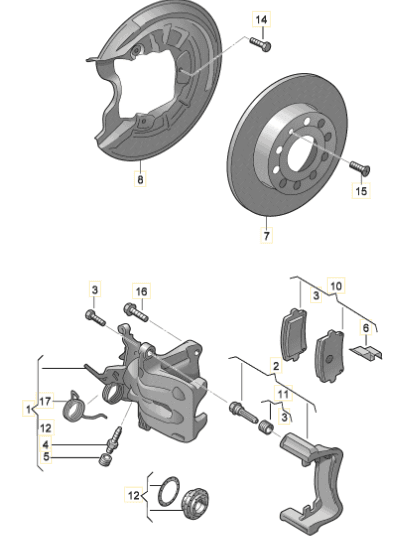

What do you mean by the disc carrier screw?
you mean the little screw which stops the disc falling on your foot?
which screw from this drawing?
RobertJames81
Oct 10, 2019
22
Haha yes the screw that stops it dropping on your foot.
Or in my case not matter which car I have - the screw that always rounds - got to stop buying such high mileage cars 😝

That small screw has no structural function in holding the disc.
The wheel bolts clamp the brake discs between the hub and wheel creating huge friction and its this friction which holds the disc.
This small screw is only there hold the disc while the caliper is off (stop it falling on your foot!), and to enable easier wheel bolt alignment.
If you 'bugger up' this screw and don't have a replacement to hand there would be no problem carrying on and fitting one at a later date. Having said that most premium disc suppliers include these small screws.
