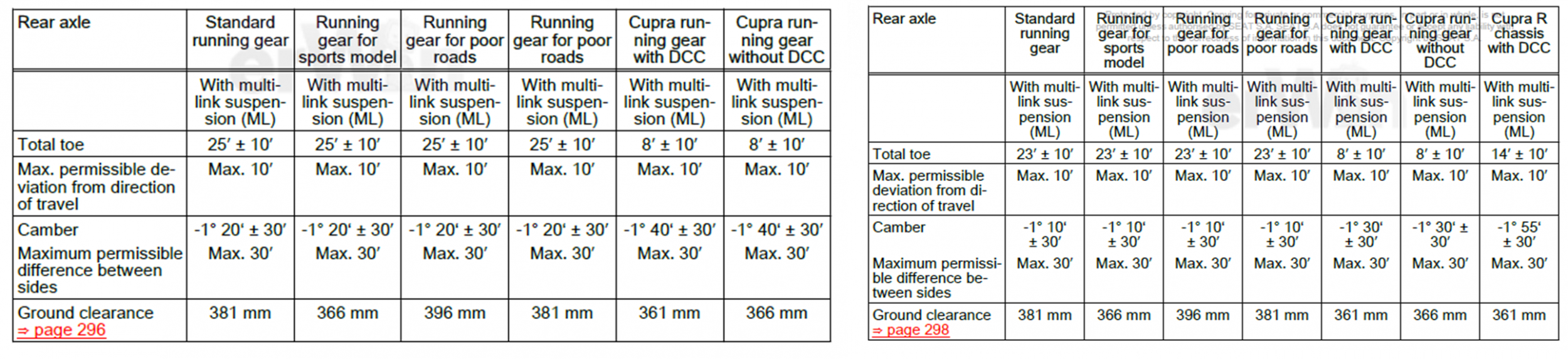

I don't know about "wrong" exactly, but I know the alignment specs were changed at some point to improve this issue and the inside edge wear. I think many FWD cars will get it to some degree- my wife's Lupo had it, a little, and I've seen it on Mondeos of a certain age (but I'm told MQB and that Mondeo have similar designs of rear suspension).
From the manual 2013> on the Left, and 2016> on the right.
Later spec has reduced rear toe and camber!
Suspecting though that the 2.0tsi of the OP is post 2016?

Yeah I'd be going for 0
4 minutes plus or minus 5 . I guess it's a little less stable in cupra guise.
