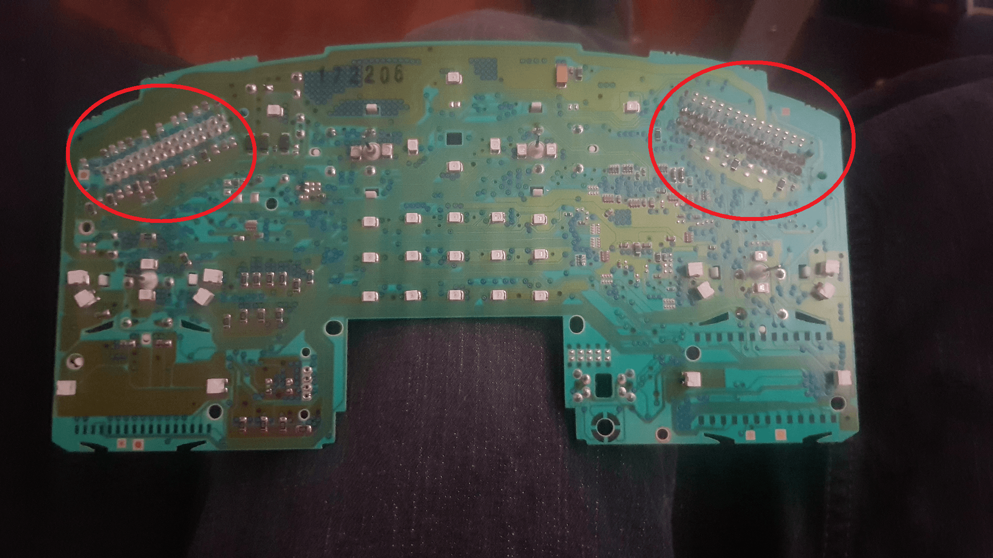

mty12345
Jun 17, 2011
3,907
538
bristol
endoftheworld did you ever get your instrument cluster fixed?
I am experiencing identical fault on seat Leon MK1 2003.
Would much appreciate any troubleshooting or fixing tips.
I had the same fault and ended up sourcing a brand new, old stock cluster for £150 (SEAT wanted over £400) That then gave me the chance to troubleshoot the old one, without the worry of bricking it, and although I didn't test it at any great length, it definitely seemed to have sorted the problem when I took it out for a short test drive.
Basically I reflowed the 2 green and blue connectors that are circled in the attached pic. DON'T attempt it unless you're fairly experienced at soldering and feel capable of doing it without damaging the board or bridging the pins though!!
Use a suitable iron (I was worried about melting the plastic connectors if using hot air) and plenty of good quality flux and it's a fairly easy job. If you don't think you're able to do that safely then there are companies that you can send them off to to be repaired.
Hope that's some help.
