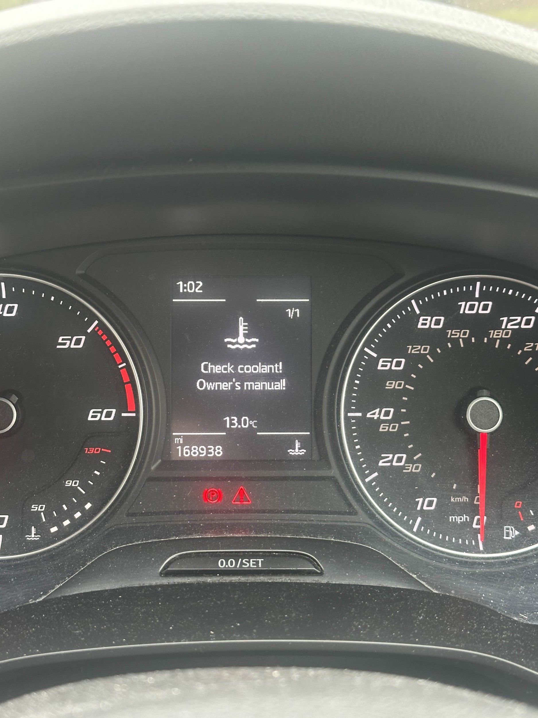

Ahh i see my uncle probably didnt do this if it is the same process. I can take it to a garage and have them do it, but if that isnt the fix its just a waste of 40 pounds
vixonss
Mar 6, 2024
26
So my uncle thinks it’s the water pump just from the description of what we’ve told him, even though it had been replaced 9k miles ago.
I also have an error code on the vehicle which (may) be the problem however, this codes been here since december and this problem has only just recently started.
Error code: P190E00 - coolant pump for charge pressure cooler supply voltage.
If anyone thinks this is the cause opinions would be appreciated!

After inspection over the weekend everything seems to be within working order.
Coolant seems to be holding fine.
I believe when i bought the car the water pump had been replaced at 161k and the coolant wasn't flushed properly after reading you need VCDS for this to open specific places to let all the coolant bleed.
Then when my uncle changed the matrix the same thing happened with no VCDS being used.
Could this cause the air pocket I seem to have.
I am thinking of booking it in with Halfords tomorrow for them to do a coolant change on it as I assume they'll use VCDS just want a second opinion on if I'm on the right track with no VCDS used causing the issue with old coolant in the system and air pockets.
What do you think could this be the fix?
