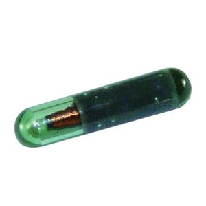

Have a problem with starting my car with the flip key, I purchased a shell flip key from eBay and transferred the internal from the old to the new shell using the original cut key and was under the impression everything was fine as it opens and locks the doors without any problem but when I put the key in the ignition and try switching the engine on it cuts out and the “electronic immobilizer” is flashing on the dash any insight to why this would be?

sounds to me like you haven't transferred the transponder & have just transferred the remote board. You need to remove the transponder from your original key & fit it inside the part of the remote where the blade it is fitted
this is what you're looking for
Aug 16, 2011
295
Huddersfield
nope, totally wrong part number! this will only work for Golf & Passat from 1998-2000
If you read back through the last few pages you'll find i've put the correct part numbers for each model & year

no it won't start the car unless you either transfer your original transponder into the enw key or get the new transponder programmed by somebody with software/equipment
