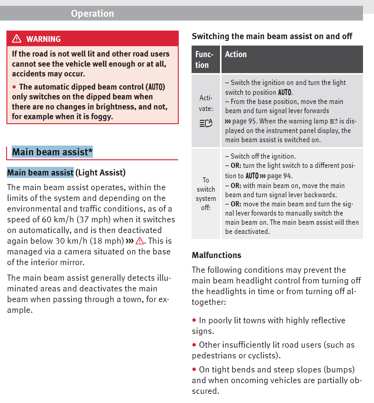

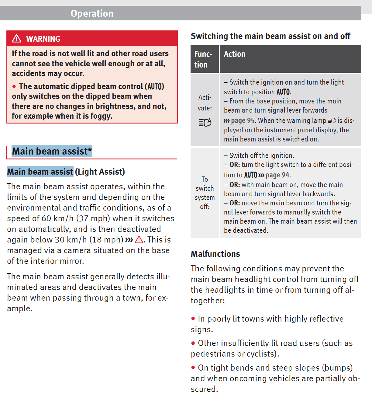

Deleted member 103408

Thanks for posting that mate.
Yeah, I've never seen that symbol before and almost definitely don't have it specced on my Leon. I do have what looks awfully like a camera on the windshield side of the rear view mirror chunk. I'll post pics tomorrow. Just wondering if it can be "enabled" by the dealer maybe.
