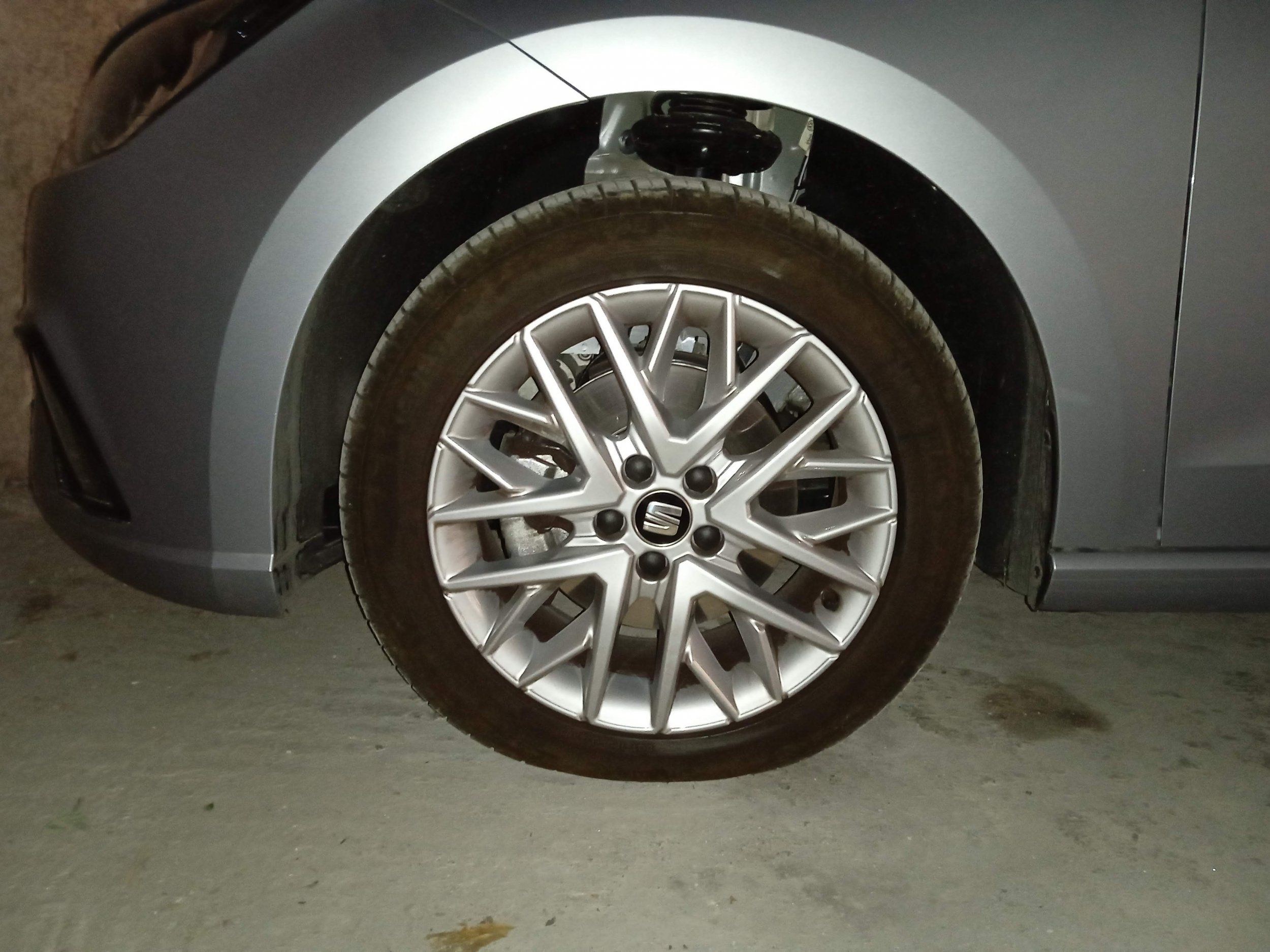

This is my 195/55 R16 front tyre, does it look a bit flat to you? Should I get it pumped next time I am at a gas station?

@AnotherLife; The garage tire pressure gauges attached to their air lines are often inaccurate, and I personally wouldn’t want to rely on one for checking and adjusting the pressures of my tyres.
I’d strongly recommend investing in a good tyre pressure gauge and a small 12 volt tyre compressor that plugs into the 12 volt power socket in the car. As @Mike Coulter has said, you can then check and adjust your tire pressures on a regular basis - it can form part of your other regular (monthly?) checks such as under bonnet fluid checks. My tyre pressure gauge is kept in my glove box and there’s room under the boot floor next to the spare wheel in my VW Polo to store my compressor so I’ve always got them with me.
Regular tyre maintenance - checking adjusting pressures and inspecting for unwanted embedded items and damage - only takes a few minutes and can extend the life of the tyres and help keep you safe.

I was about to say that tyre looks like its around low 20s PSI. I bought myself (been using it over 6 years now) a digital typre pressure handheld thing. Works great! I noticed my tesco petrol stn tyre inflator thingi tends to over read by 1-1.5 PSI. So I usually over pump it by 1 or 2 psi, and release air accordingly later (much easier this way). I know it's crazy, but 4-5 years ago, it cost just 20p to add air. Then couple of years ago, it was 50p, last week it's now £1 :(.
Please note recommended tyre pressures stated in the fuel flap or drivers door area are for cold pressures. So you 'may' need to add 3-4 PSI more on fronts (if you just had a nice drive) and 2-3 PSI extra on the rears. Then probably when the sun goes down 2 hrs later after parking up, check the pressures and reduce accordingly. I'm not sure what is the stated pressures for 195/55 R16s but I'm guessing it would be low to mid 30s PSi.

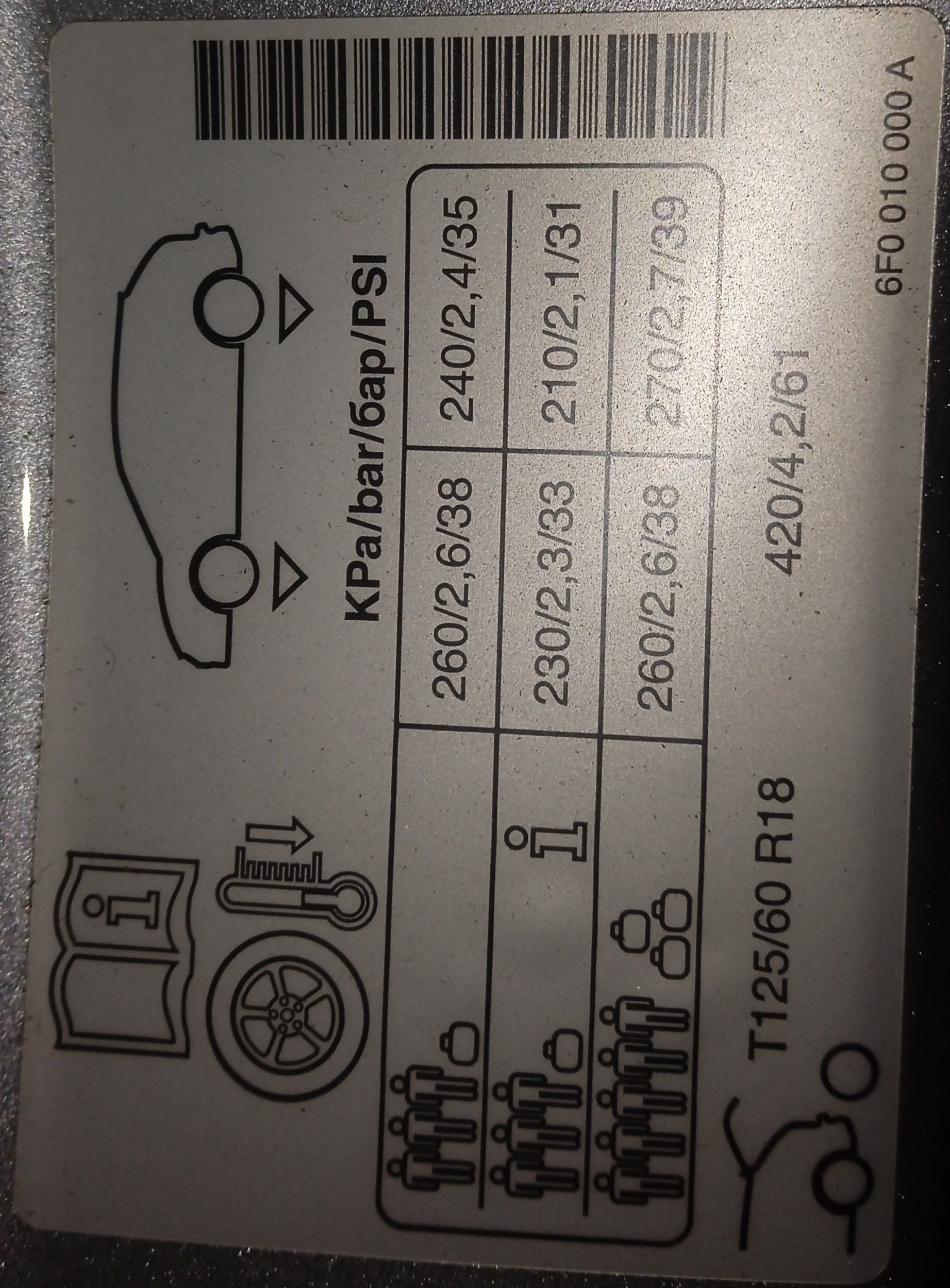

I am attaching a photo of my sticker, that's where I got the 33/31 psi from, the comfort values. But is it for my tyre dimensions?
And what is that crazy tyre dimension at the bottom? The dimensions of the spare wheel? I just checked my spare wheel, it is a Michelin 185/65 R15.
Those pressures should be for your tyre size - there’ll be other versions of the sticker used by Seat on the factory production line for other wheel / tyre sizes and the production assembly workers will attach the correct sticker to each car depending on the wheel / tyre size fitted.
The tyre dimension at the bottom of the sticker is for one of the skinny space saver spare wheel/tyres.

How long have you not checked your pressures? From what I saw and from experience (nail in tyre, and TPMS pings), my 205/55 R16 on a Leon looked just like that, a little buldgy! And it was low 20s PSI. Even after a year, it would not drop 10 PSI if you have a newish car and newish valves.
