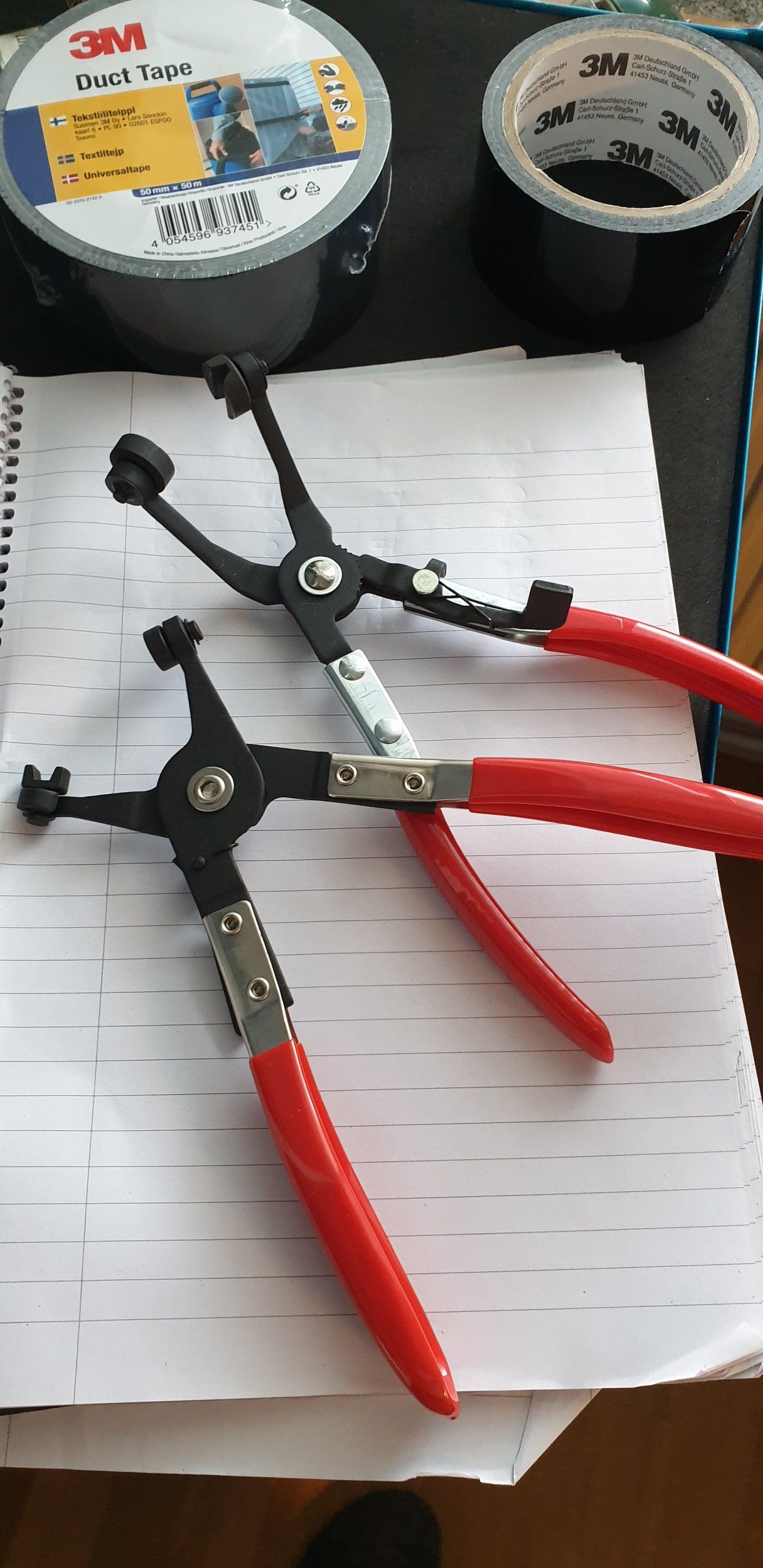

I have two hose clamp pliers, one straight an one angled. It will keep the clamp open (expanded). The clamp will grip again 100 times!
You could use any one of those two in this case, see pick.

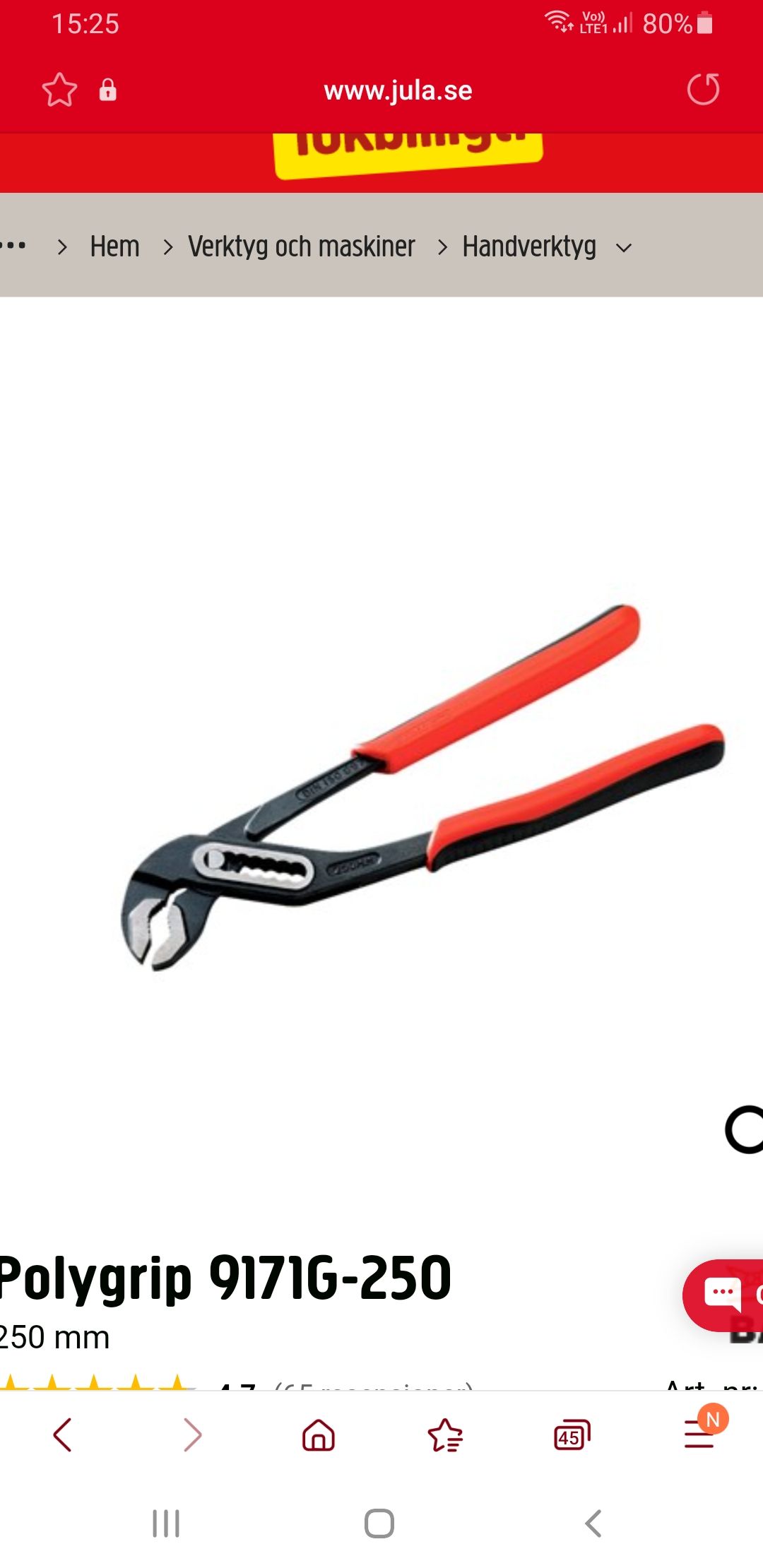

Do you have a polygrip? If "yes"try it.

I'm guessing the pliers in your photo are lockable? I do have a ply grip but I'm worried it might be difficult getting it in there as it's ever so slightly tucked away. Might just go pick up hose clamp pliers to make my life easier. Thanks for your help man, really appreciate it :)
