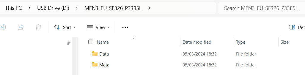

OTA is not proposing to me any update, so I tried to do it manually with USB.
I managed to get a link from another post for the files (MEN3_EU_SE326_P3385L ) I need but unfortunatly the system infortainment does't detect any new SW in the USB, and I don't see any option to select file from USB. Should I enter to engineering mode and if it's the case how can I do it?

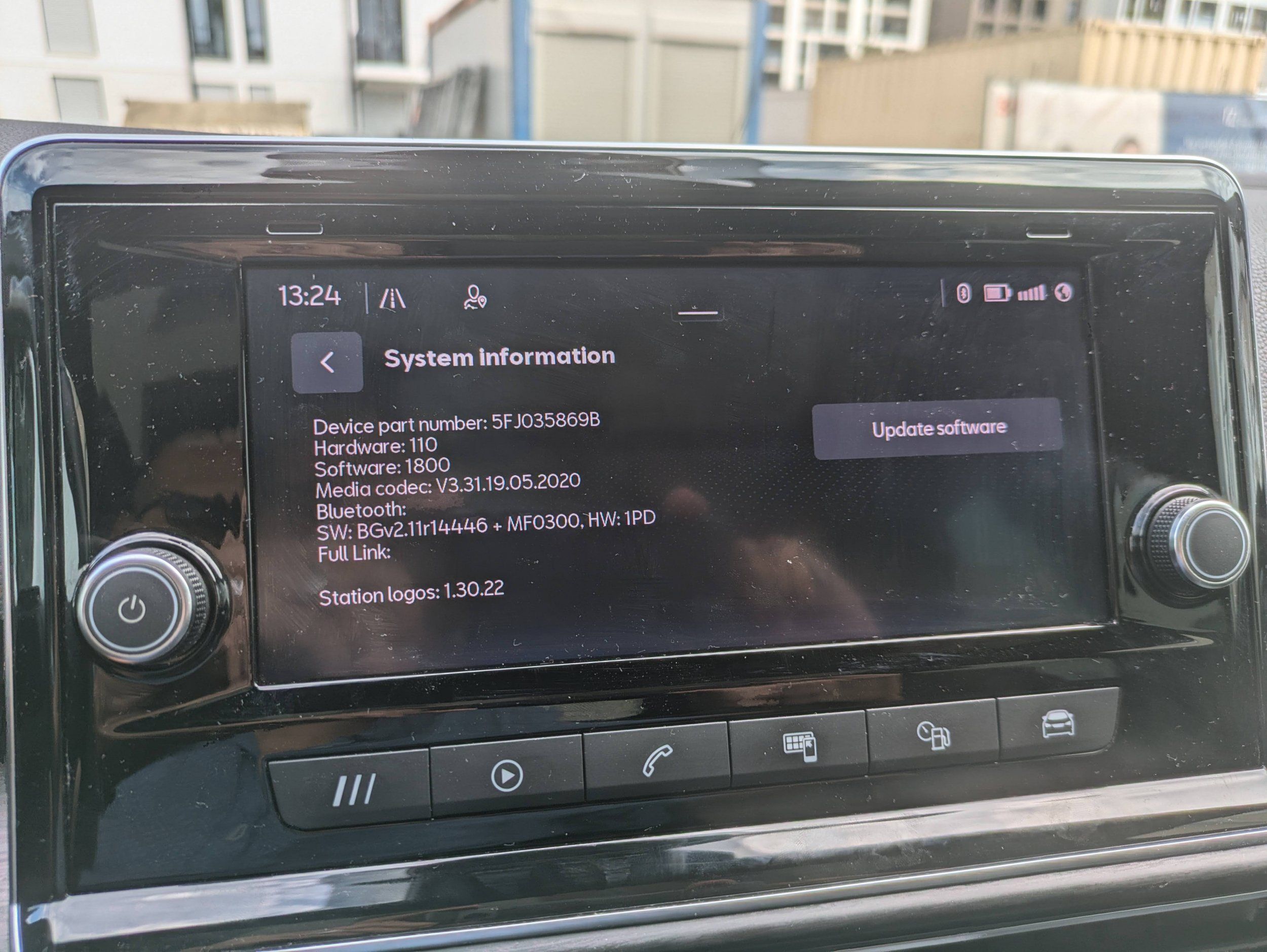

I don't have the same Unit described in that post. mine is the small screen. I tried this method of holding the menu button (3 stripes ///) and going to Software update menu but it didn't change anything.

try pressing the "car button" the one at the far right for 10 seconds.
And be sure to have a full batterie in the car, turn off climatcontroll. It will take a while to upgrade.

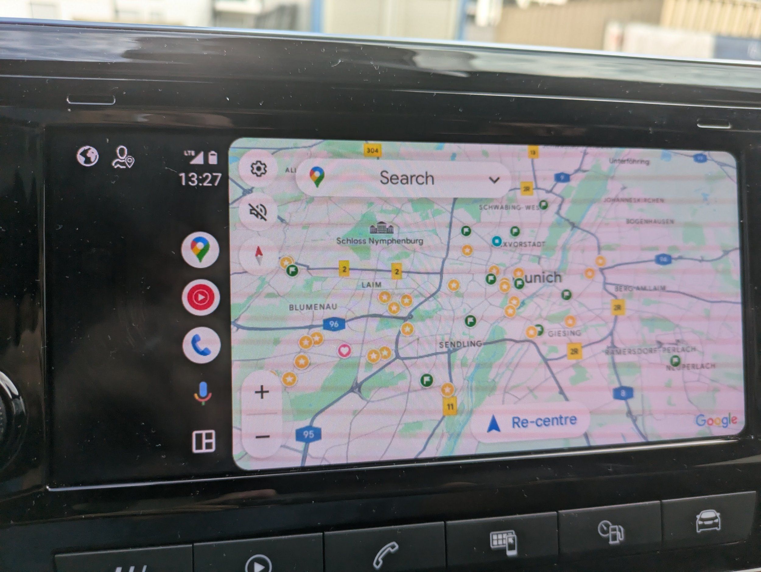

Thanks a lot, that worked and I managed to do the upgrade to 1800 version. unfortunatly my problem is not solved. I will ask in another thread.

Android auto isnt the best on that small screen. I have the same one and its slow and doesnt cover the whole screen.
Aug 19, 2024
I made a mistake by not taking the larger one. I didn't want to pay for the Navi and ended up with this low end screen. Difficult to see the difference when ordering online and the only cars shown in dealership are with the big screen.
Jokke
Jul 15, 2024
23
Sweden
hopefully there will be an update so android auto uses the whole screen, I have seen Ibiza cars from 2024 where they show fullscreen android auto and apple carplay. Its software related.
