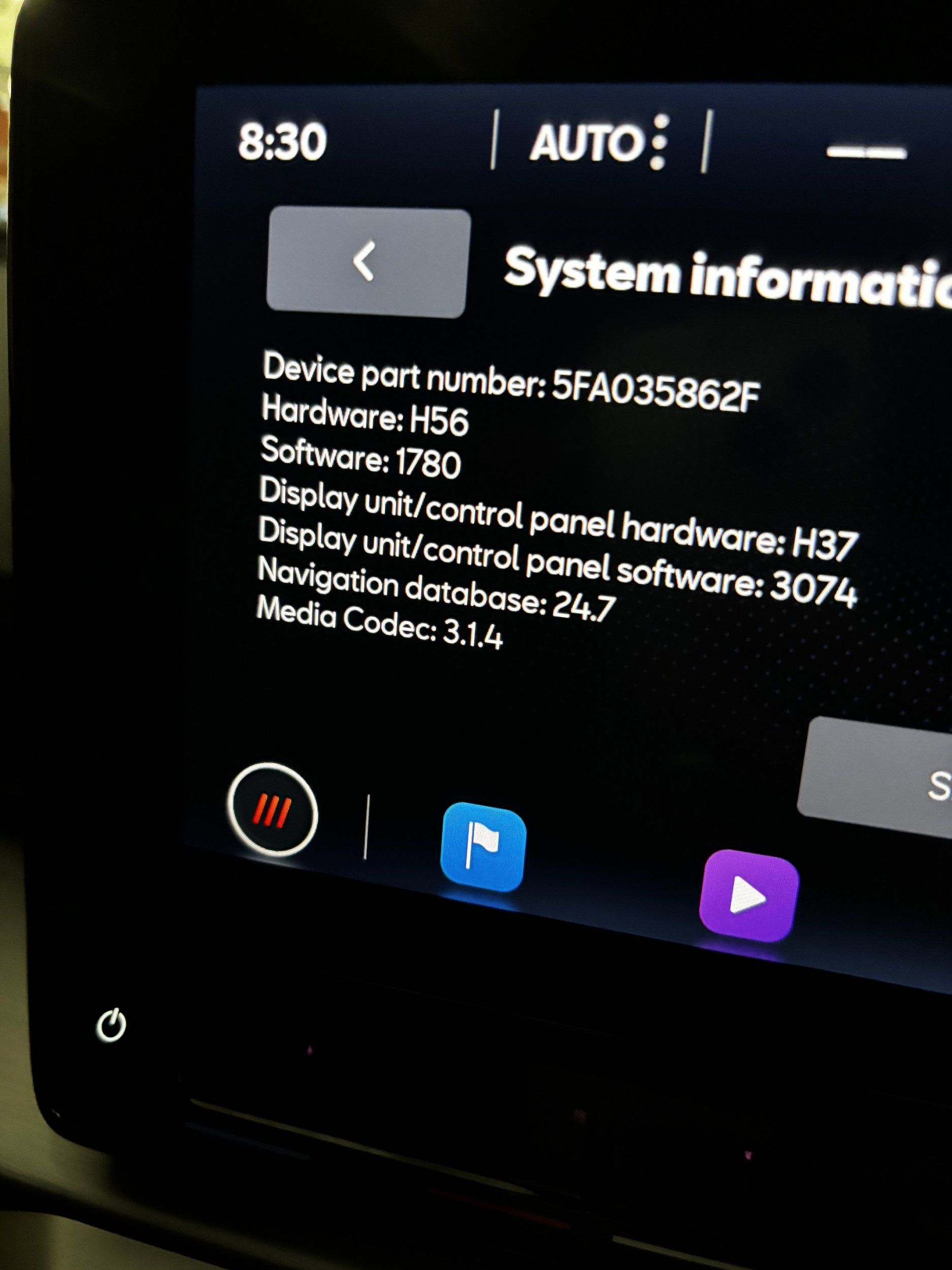

Hi, you have a very old (more than two years) software on your infotainment, that has a lot of bugs. The latest is 1969, so update first and then check if the problem is still there.

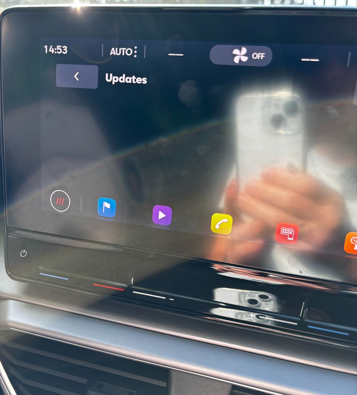

Ah great, thanks for that info. I’ve not long had the car so previous owners must not have updated it.
There’s nothing showing in the updates screen, is this a manual or garage job?

442
134
first install version 18XX and then version 1969. install via the service menu
The update can be made either by yourself ( if you have some minimal tech abilities) or at the dealer - but if you don’t have warranty anymore it can be a pretty high cost. Major updates don’t arrive OTA (over-the-air) if you have such old firmware as you do.The thing is that you cannot jump from 17xx directly to 19xx, you have to make the update consecutively ( if I remember correctly 1803 is in between). To do it yourself, you cand find all the informations step by step on this forum, or google.
