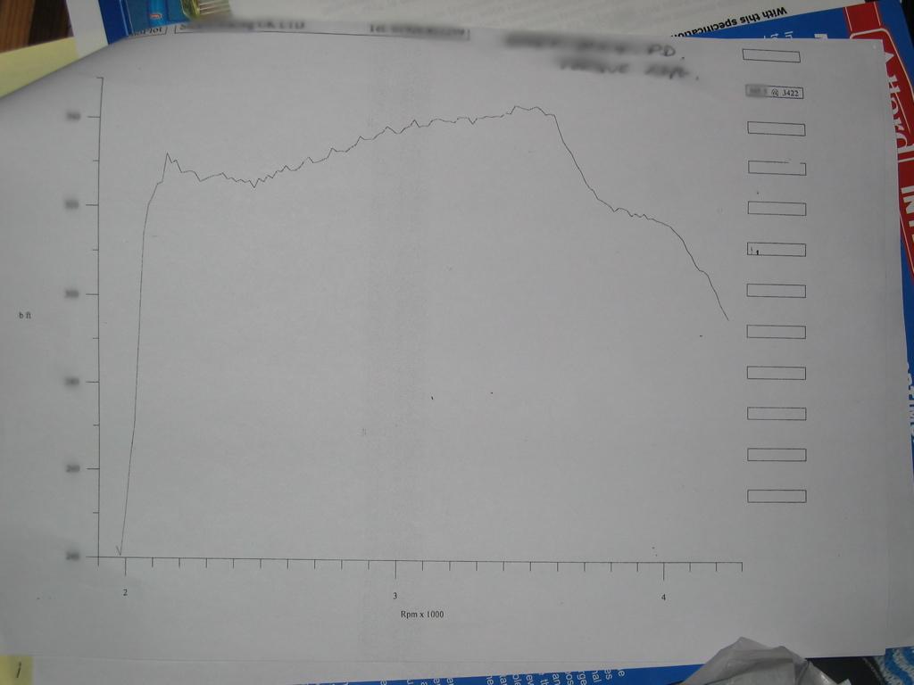

problem with TDI is you have a relatively narrow rev range - ~1700rpm->4500rpm is about as good as you'll get. (my peak torque with my fairly modded PD130 is at 1700rpm..)
Adding a bigger turbo is going to increase lag..which reduces that range futher.
Companies like Revo, AMD, and jabba create their maps to make the car as driveable as possible, which means giving power over as much of the available range as possible, and they can do things to limit the torque, resulting in a fairly flat torque curve.
So you could end up with something like: http://badger.ing.me.uk/torque.jpg where the peak torque wasn't record breaking, but it was held over a very large amount of the rev range...
but as SBF said, it is difficult to see the point of them, unless you have a specific reason to do it...you can get close to 200bhp relatively cheaply, with remap (be it Revo, AMD or Jabba), you have the FMIC as standard with the ibiza cupra, and then get a milltek exhaust (it sounds lovely, I have no sound clips, but at the recent JBS rrday, it got a lot of approving nods...its no ABF, or screamer like RobT's car, but it sounds butch, and ace for a diesel)...and going beyond that gets expensive...
