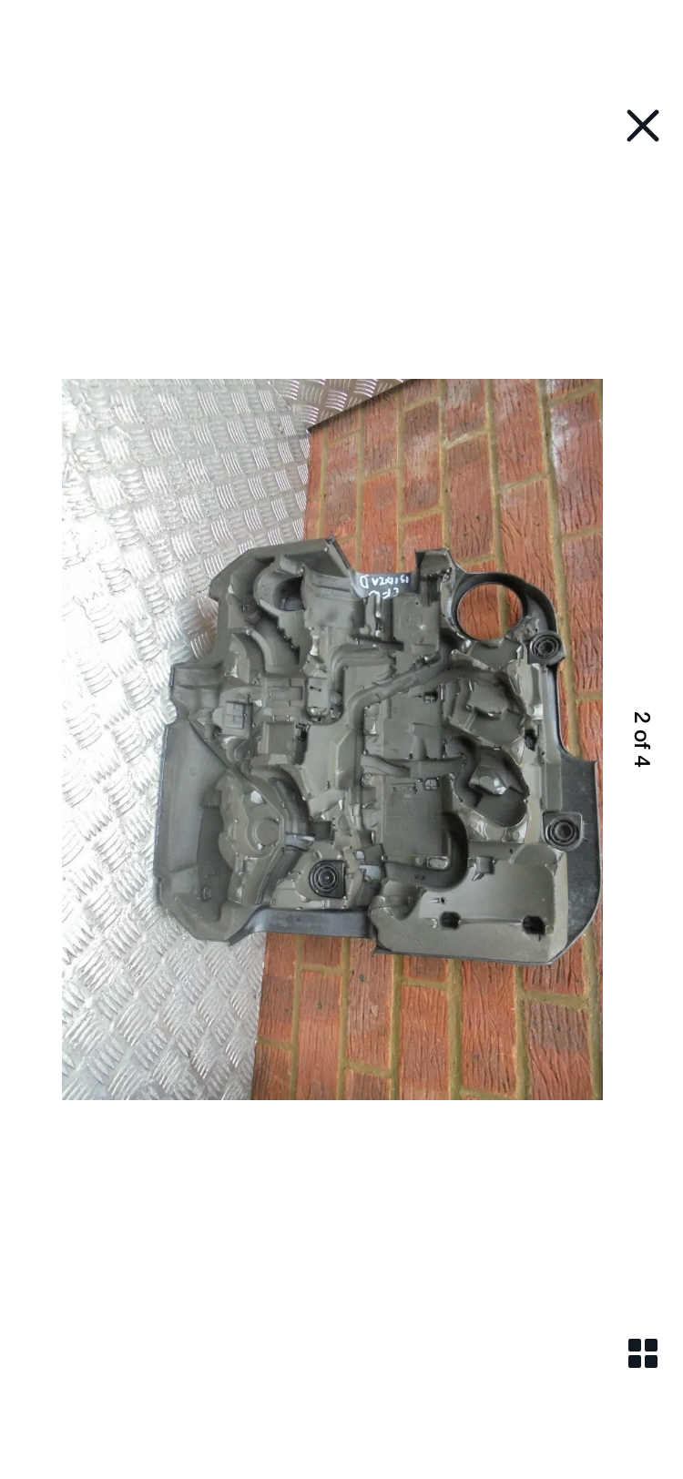

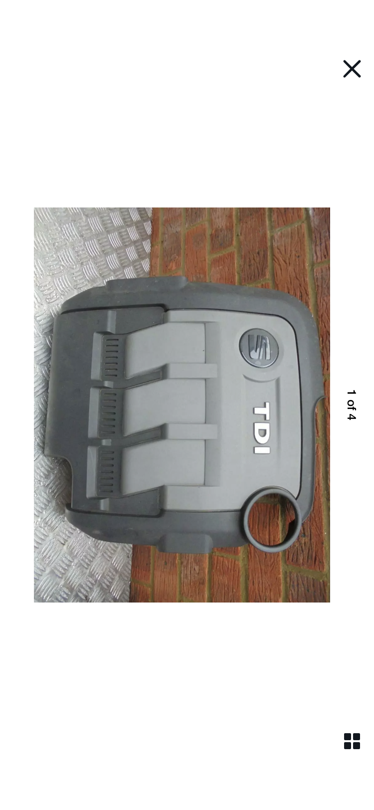

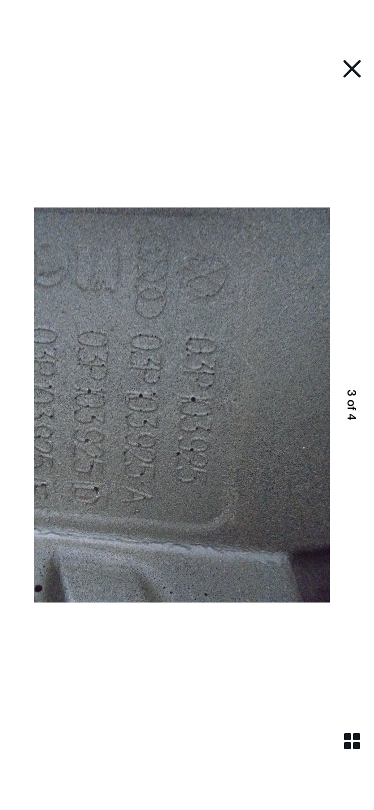

My daughters Ibiza Came without an engine cover, So I bought a 2nd hand one as it was just down the road and cheap. But I am not convinced it is the right one ? Any help gratefully received See pic of Engine, and the cover I have ?

Thats a 1.2 tdi engine cover.
Has the car ever overheated ? That white residue looks weird and I believe its from coolant overflow. Also the coolant expansion tank looks replaced and empty ! Be aware, these cars do not have a sensor for coolant level !
