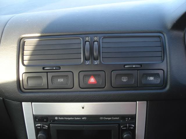

heres what i used:
-]http://cgi.ebay.co.uk/12-volt-12v-...s_SM?hash=item2c50446132&_trksid=p3286.c0.m14
-2 washer jets(get the ones that spay a fine fan type mist)
-2m of 4mm tubing, 1 x grommet, 1x barbed take-off, silicone sealant,
-1x one way check valve(or else it will syphon out lots of fluid if the jets are below the tank which they probably will be, mount as close to the nozzles as possible to speed up spray time and minimise water loss)
-2-3m or 1mm wire, 30A relay and a button to activate it(i used a funk button in my mk4 golf http://i173.photobucket.com/albums/w56/Murr_2007/ad7250b2.jpg)
very simple to install there nothing fancy it just wets the intercooler when i press the button
