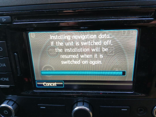

Hi Guys..Has anyone bought the 6PO919866 V12 2020 SD card and did it work straight away..Thinking of getting one but read so many different stories about updated SD cards and that only Seat main dealers can supply and activate them? :think:
Thanks.

I'm on 6po919866 v.12 now. Just plugged into the sd card slot, and after a few seconds it was up and running. If you order from the web address I posted (www.satnavstore.com), they supply oem cards. The current price should be around the £35 mark.
Hi Steve.
So they work straight out of the box and don't need dealer activation even though I don't have Map Care. I've seen other posts on the forum that its a mine field to get these to work. Regards.

You dont need mapcare. If your infotainment system has that sd card 6PO919866 in either of the card slots, that's where your sat-nav gets all its info from. That company I mentioned supplies cards that (if activation was ever required) simply slots into your sd card port. Give it a wee bit of time to update anything in the head unit's firmware, then you are good to go!
Think of it like this - your dealership is preying on your ignorance of how this works, so they exploit you by telling you nonsense, such as:
you'll need to leave your car with them, as it's "very technical".
Its expensive because your head unit is actually a small computer, and needs reprogrammed, etc...
Worst case - the card doesn't work, so you send it back for a refund. What's to lose?
Its expensive be cause your head unit is actually a small computer, and needs reprogrammed, etc...
I'll give it a shot then.

If you order tonight, they will despatch your order tomorrow, so you should get the card by friday latest. Any probs, I'm here - locked down and loaded... well, I was loaded, but I spent a fortune stocking-up during this pandemic! LOL

Its ordered...fingers crossed and all that.... Ill let you know if it works.
