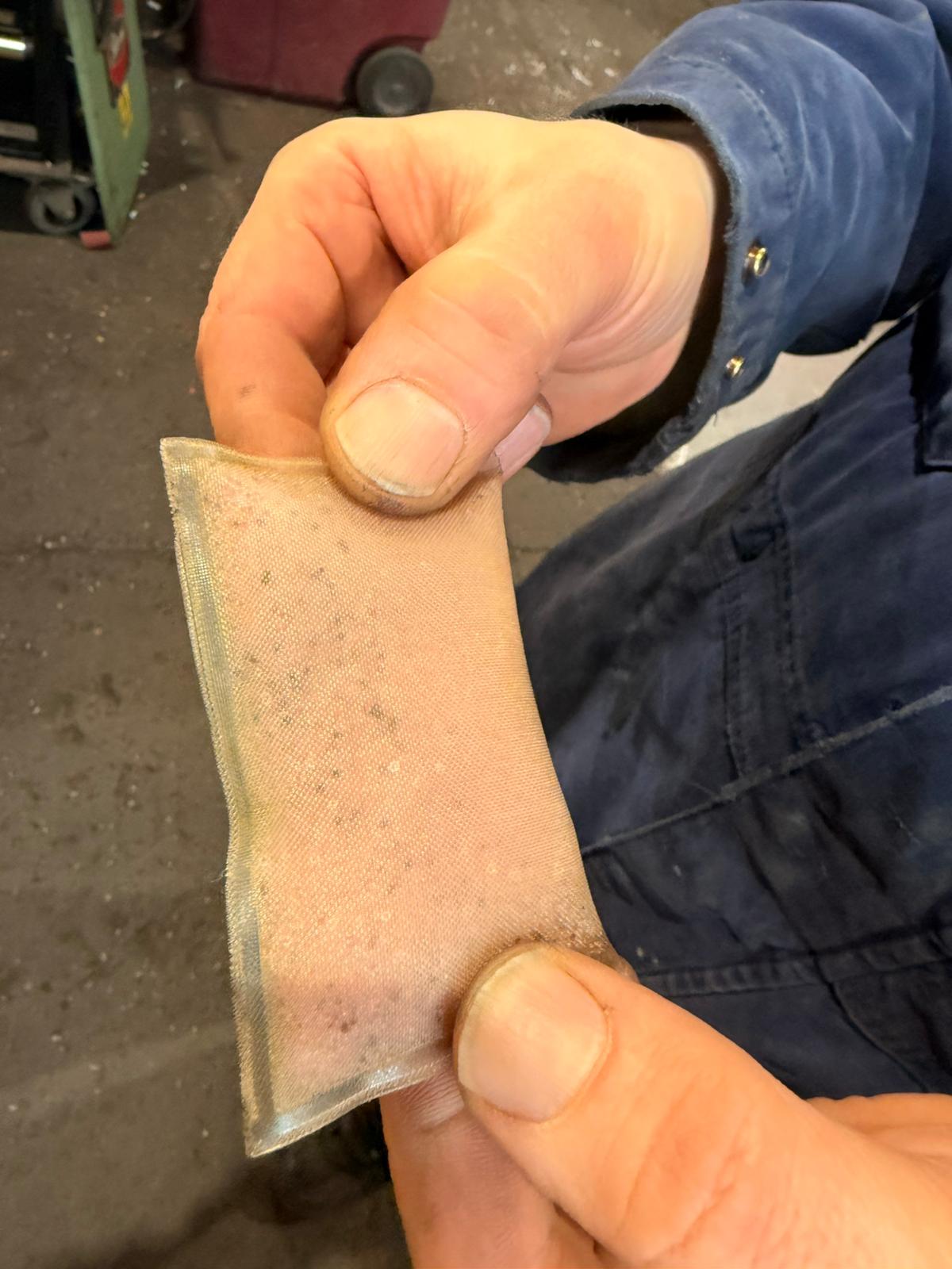

Follow this POV video if you want to remove the silica / silicat bag from the coolant expansion tank. They are known to rupture, where the silica beads will run through the coolant system and clog up the heater matrix. This will result in costly and unnecessary repairs.
When you remove the silica bag, it's also recommended to swap over to G12 EVO coolant instead of G13. Coolant is NOT a lifetime fluid and will lose it characteristics over time and usage.
