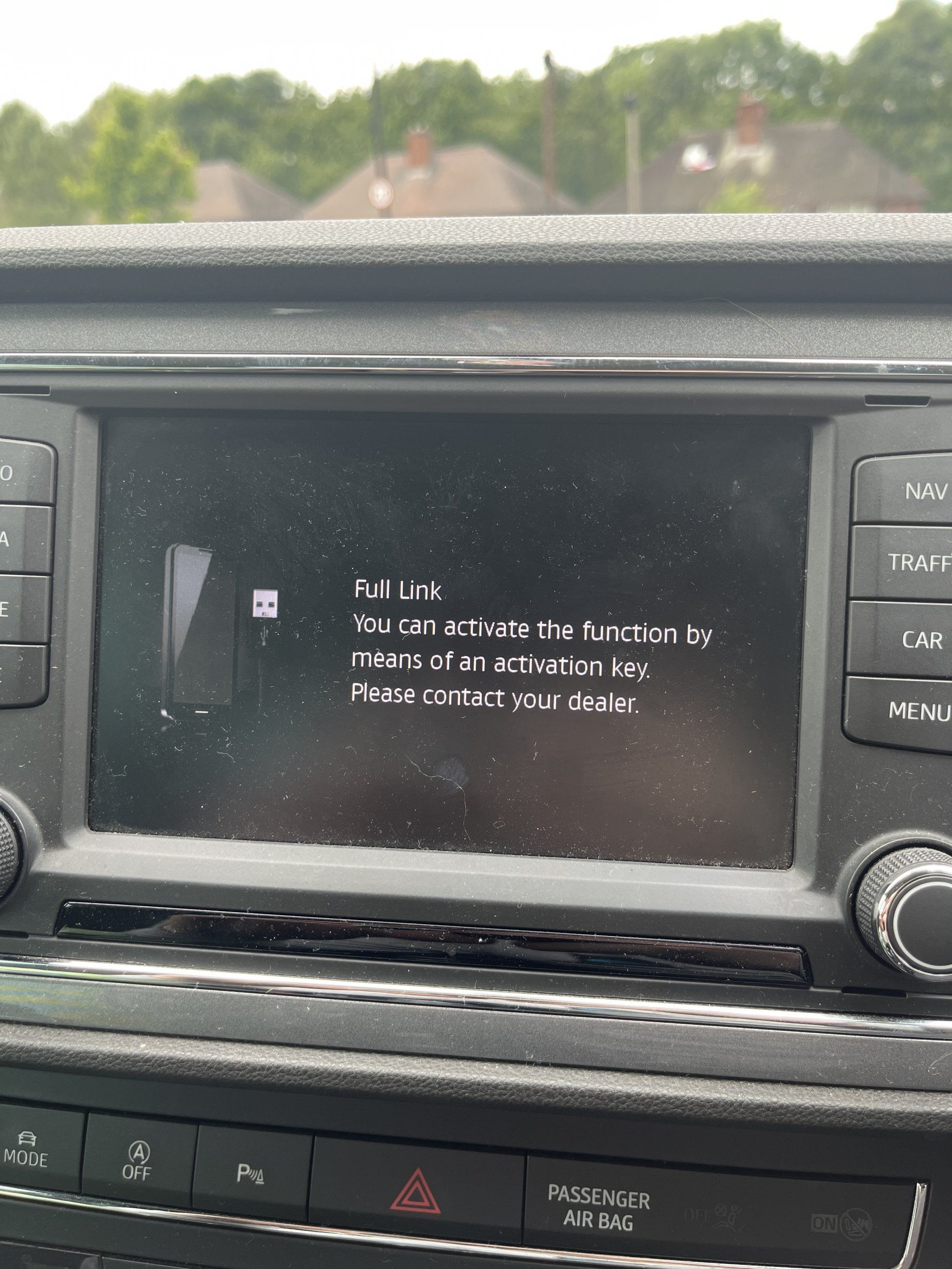

How to activate Full link
Jul 9, 2024
How do I activate it

why don't you do it yourself?
If you do the necessary update to allow for Full Link activation, you'll have to code the software management into the control unit. If you need to code yourself, it'll cost you money anyways, so why not grant the local specialists the business? I've had to get myself the OBDeleven tool and the pro subscription because nobody in my direct vicinity even knows what they're doing and the dealer charges over €380 euros for an update.
cairus
Jun 4, 2024
432
134
The Toledo type KG has a MIB2 installed, or am I wrong here? I have never needed an FEC code for a MIB2 standard for full link. There are two options, the first is to install the toolbox and then install the patch. You really need a diagnostic device for this because the developer options have to be activated. Or option 2 is to use a full image where CID and CP are also patched. A diagnostic device is only needed for the "Software Management" error.
only for the USB interface you may need a diagnostic device
