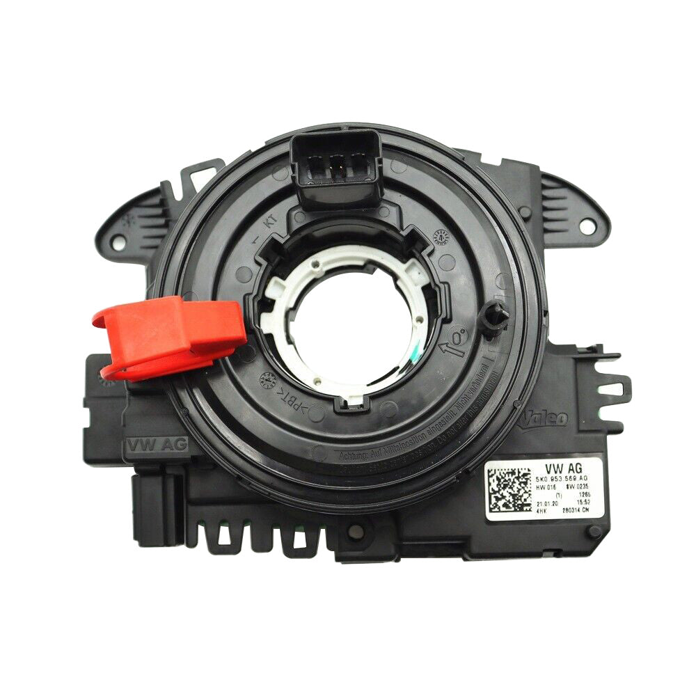

Evening all, so I still have the issue. I have had the horns off and checked and they both work fine. Relay replaced, dues checked. I’ve even replaced the clock spring but I’m still getting nothing from the horns. Would VCDS bring anything up if I could find someone local to Tamworth that would check it?

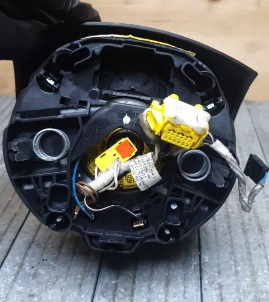

I’ve taken the airbag off again this morning (battery disconnected) and checked all the plug connections by unplugging and reconnecting a few times just to make sure they’re all making good connection ie no corrosion etc but still nothing. Would replacing the airbag unit possibly rectify this issue? Didn’t really fancy trying to take the back off for obvious reasons. Can get a second hand unit on eBay for not too much money.
Shouldn't have thought so. Airbag unit normally just presses against the contacts, doesn't usually contain anything horn related.
Would I be right in saying the contacts are all inside here though? Was a bit wary of actually splitting it open to check as I’m not sure how to open it if I’m honest. Didn’t wanna knacker it up by trying.
Yeah looks like they should be inside of that. It's a lot different design to the mk1 so not familiar with how it's set up.
Reckon it’d be easy enough to separate to check the contacts? Or would I be asking for trouble and creating another possible issue for myself? I’ll put my hand to most things but never messed with an airbag unit before ?
