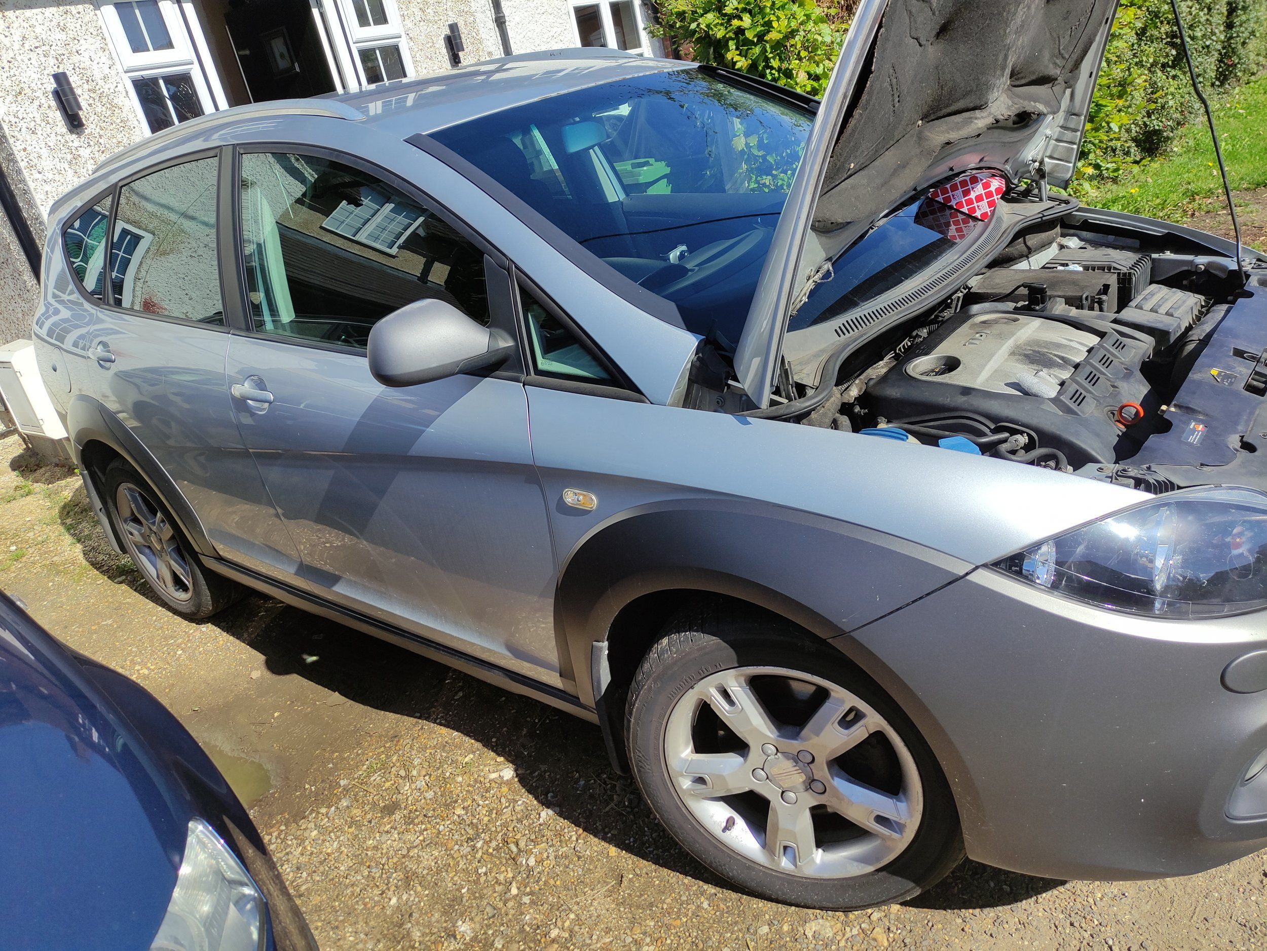

Sorry for the delay Mr Syphon, it's been a busy week! Here she is, the bonnet is up because I've just started servicing her. So far I've done the fuel, air and cabin filters. I've cleaned the MAF sensor but, I can't see the MAP sensor? Any pointers would be most welcome! Oil change tomorrow hopefully, any tips on that would also be great. Thanks!
I've just bought a 57 plate freetrack tdi and I've got the same thing with not quite boosting properly!
Currently looking into it
Hi Jimmy, I have just cleaned the MAF sensor on mine and that's made a big difference. She starts a lot better and drives a lot smoother. The fuel economy has also **** up according to the computer. I want to find the MAP sensor next and give that a good clean. Please let me know what you find out on yours and I'll keep you posted with what I find. Cheers!
