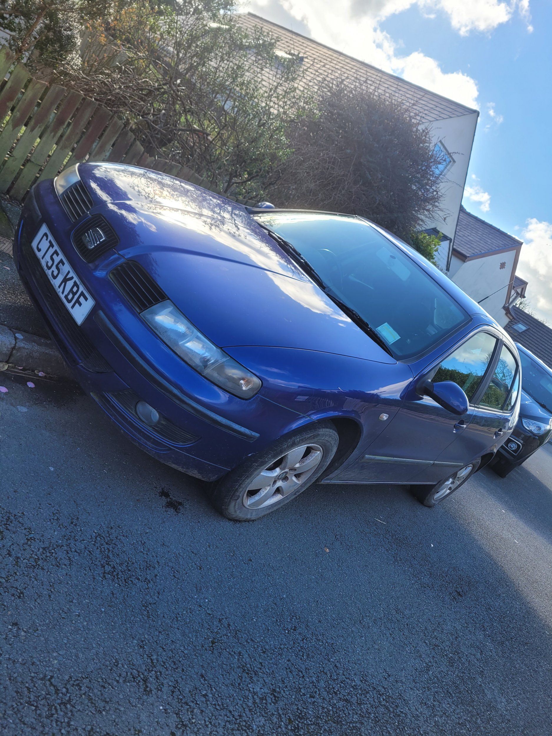

Dunno if anyone can put a finger on a couple if issues I'm having. Got my leon as a non runner due to fuel pump but that got sorted in a couple of days, but since then have had eml warnings for egr and map sensor, both of which I've swapped out and still getting issues, I know a simple code reader ain't gonna diagnose deep issues and waiting to get the car deep read for codes. Now its come up with a fuel trim bank one code. Would this be an air/vacuum leak, or could it be like the garage have said, a lambda sensor that's on uts way out? Some folks have even said coolant temp sensor, so I'm blagged, I don't mind swapping out parts but dint wanna be doing it unnecessarily. Sorry for the long winded post, just pulling out what's left of my ever thinning hair ?
