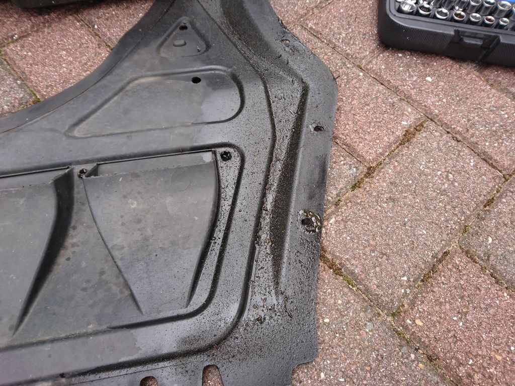

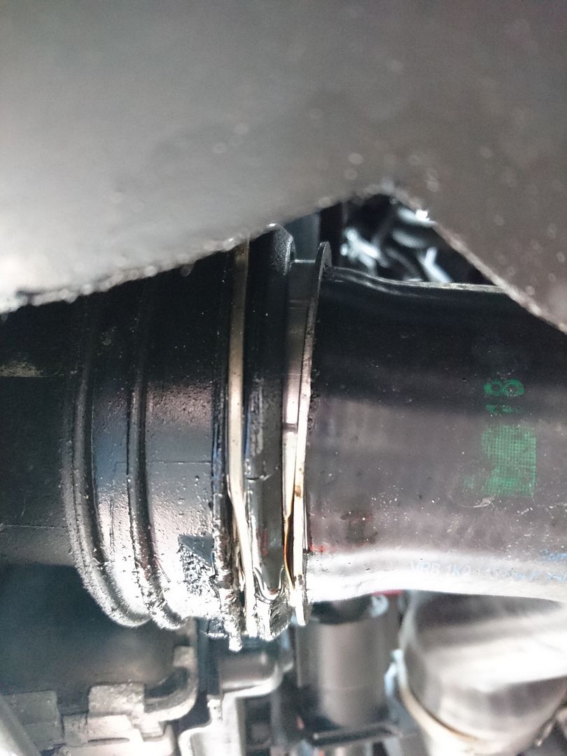

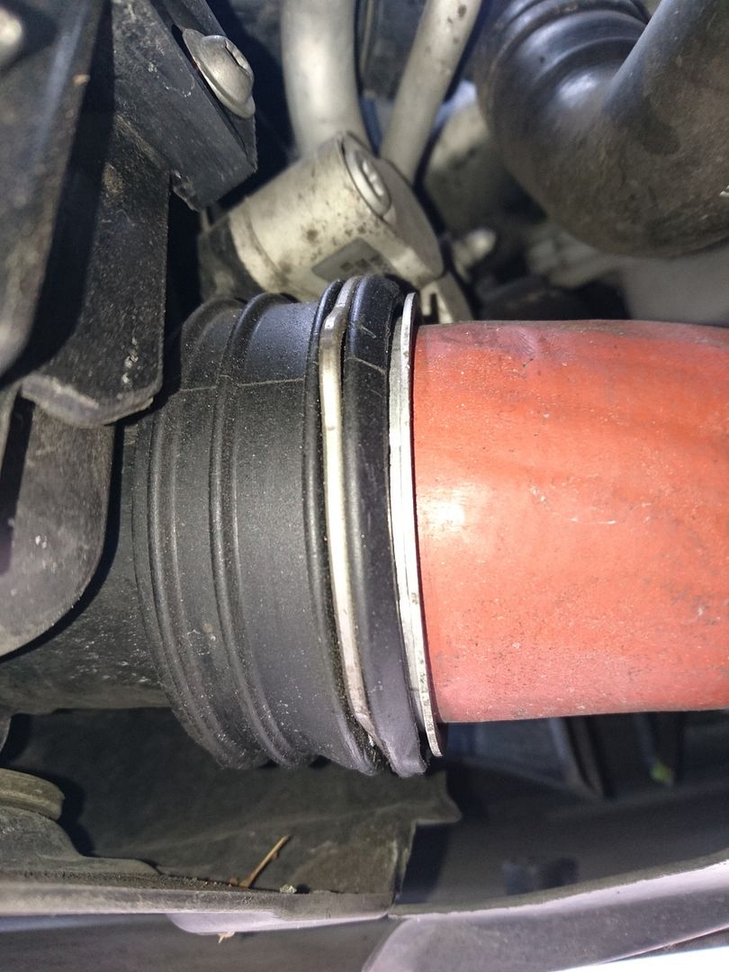

So I had the underbelly off today to change the oil and filter. I discovered that the boost pipes fitted to intercooler were not fully seated, with the worst of the two being the black one and the red was just slightly out. I had these pipes out last year to change the seals and the horseshoe clips as they were hanging out last year but a lot more than this.
The pipes were not loose and I could not pull them out without removing the clips, they have just dislodged and stayed like it.
Is there any upgrades or tweaking that can be done to stop them coming out, has anyone else had this problem and could this be causing the hesitation if the pipes are moving and leaking boost maybe when the engine rocks on acceleration?

Have done 100 miles since refitting pipes and they have moved out again as above. Do I need to change the intercooler or the pipes to stop this happening?
Dan FR
Meth addict. Stage 2+ Yo!
Nov 14, 2013
1,794
8
Caerdydd
You'd need to examine both the pipe and itnercooler connection to see which has worn. Perfect excuse to upgrade and do away with those troublesome bayonet fittings
