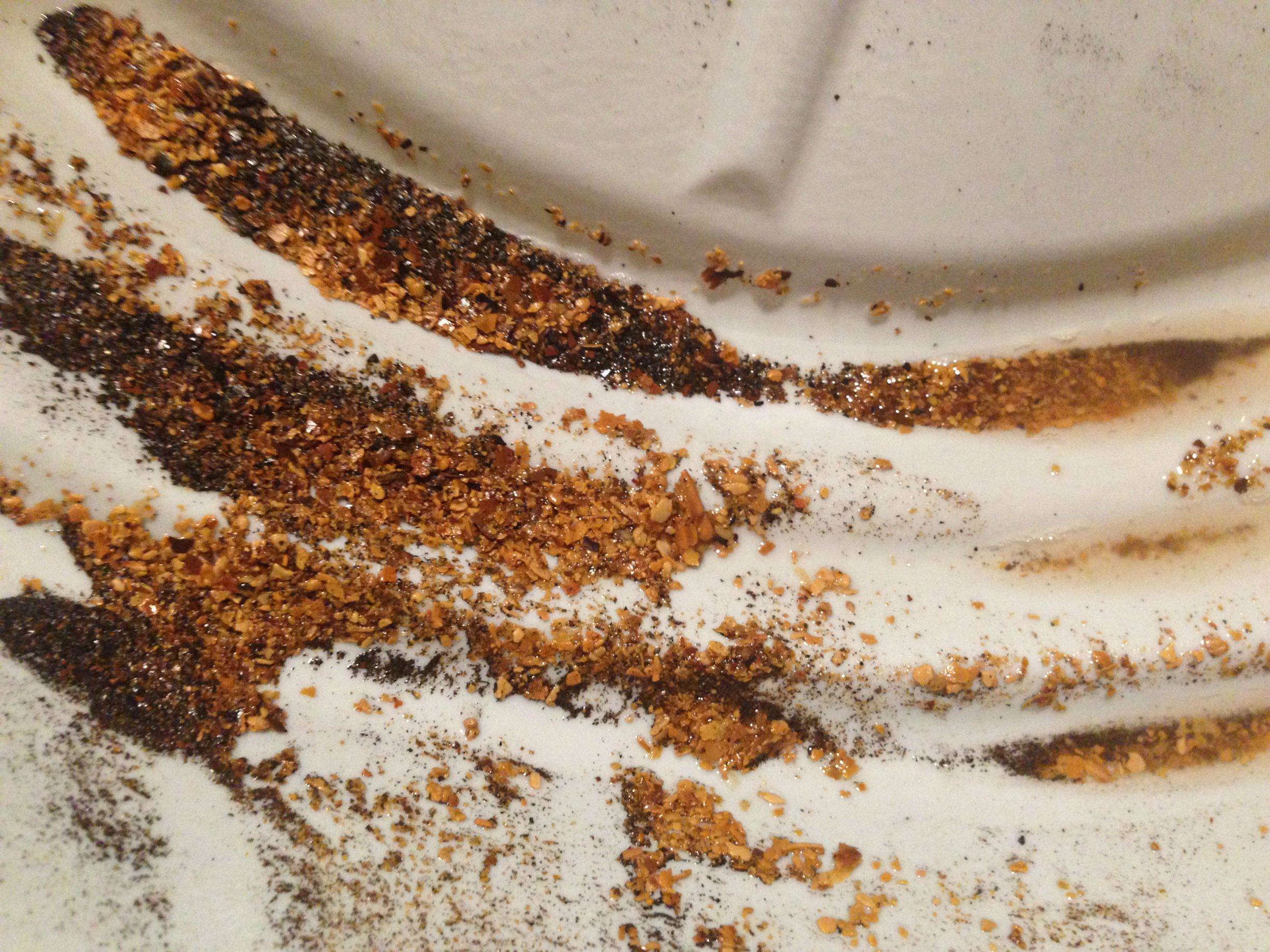

My wife has a leon 1.6d. My brother worked for seat the time these were getting rolled out and it's casting sand from when they cast the engines that wasn't cleaned out properly. It goes around the coolant system and blocks the heater matrix. My wife changed hers and flushed the system and it's just done it again. I called seat a while ago when it happened with the information and the tech asked me why I put sand in my cooling system. Seat are useless
Have a look in the header tank and see if the silicate bag has split.
The "sand" is generally the silicate from the bag that has now found it's way in to the heater matrix.
After sorting it out - fill with the G12evo coolant and fit a header tank that does not say "mit silikate" on it.
It is actually a combination of the silicate gel ball things and casting sand. @lmwood is correct. Unreal that it ever happended but it did!
This is a pic posted by someone else of hteir matrix contents. Even looks like limescale particles?
