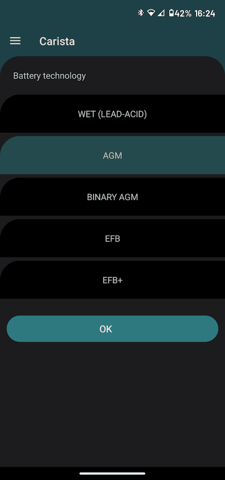

on the other matter of the battery type. i took this screen shot of carista yesterday....
so at least in my up to date android version of carista there is no option for "fleece" so i left it at AGM for the moment.

AGM is the correct setting in this case.
Carista have just renamed ‘Fleece’ to AGM to make it easier I would imagine.
Splendid good to know!
