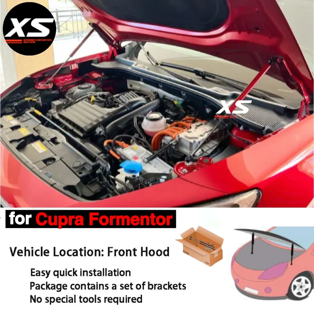

Hi, Just fitted a pair of gas lift struts for the bonnet. Got em from Ali Express
£26.55 inc delivery.
Came with the fixings, just needed a spray of grease on all fastenings. The car is already drilled and a tapped thread ready for them, but the hole is covered with a small black rubberised sticker. You simply unbolt the colour painted upper fastening bolt on the bonnet and insert the supplied ball joint bracket, then re-attach for the top fixing. (12mm nut)
The lower fastening as I said, remove the sticker, put fastening in and tighten - lower nut 10mm, upper is 12mm. Snap on gas struts and test.
On the link someone has posted pics of the job done if you want to see result.
I wish I'd gone for the red to match car colour, but then again how often is the bonnet open!!

hey, new here so looking around as i just got my Formentor. Saw this. Looks like quite a cool mod. Found another thread as well.
I saw this one on both Amazon and AliExpress as well. Curious to your experience: did you damage something inside? How are they? Easy to open/close? :D

Work great, still functioning, good simple mod. No damage caused, and I always put a spray of Rustoleum rust killer spray on stuff I fit.

Hi,
1 year later, they're still working good.
It only require a bit "load" to close the bonnet properly, in order it becomes properly latched.
The bonnet's own weight is not enough to close efficiently.
