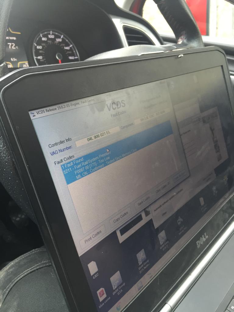

Update folks took the car back to garage it was originally in they say there is no leak and that the smell is normal which is a load of crap so I have cut my losses and decided to take it elsewhere for them to diagnose the problem . The smell tends to happen when I turn on the A/C but there must be some underlying issue because my car still goes in limp mode getting P0087 as mentioned already replaced in tank fuel pump , had wiring to pump sorted as there was an electrical fault which is why the pump went in first place. Fuel module relay replaced, Fuel regulator valve replaced too so I am hoping this guy I took it to now can sort it. The last mechanic seems to indicate the reason for it going in to limp mode is because there are metal contaminants in the car and it is getting stuck to the filters on valves on the fuel rail which causing to go in limp mode . Could it possible be the High fuel pressure pump ? I am seriously out of ideas as to what it could be and just thinking of getting rid
