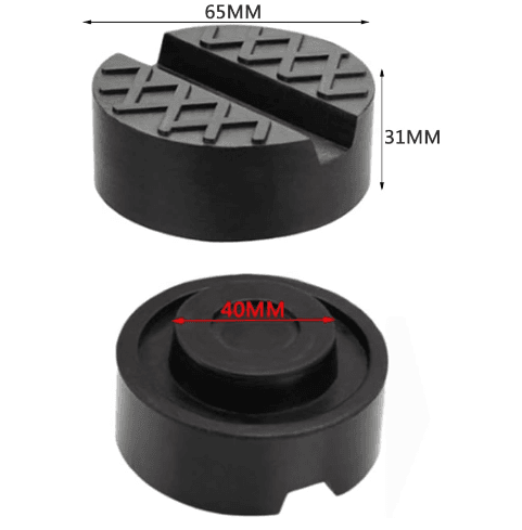

That's for using the jack supplied with the car, just wondering if you would use the same point using a trolley jack with the disc shape? Will likey just buy an adapter pad for the jack

I’d think so, if you can see that there are 4 strengthen lengths of folded-welded sill, then why not try to fabricate bespoke adaptors to place on your trolley jack saddle maybe 150mm long, shaped to sit on either side of the strengthen area using the folded section only as a “locator” and fitting high density rubber on the contact surfaces.
In an ideal world you might need 4 different profiles to exactly suit each of the 4 positions.
Or, if that sounds like being too much bother, just buy a suitable slotted compliant adaptor and like others live with lifting on the folded-welded points.

I bought 4 rubber ice hockey pucks on Ebay, and cut grooves to fit on to the jack points and they worked a treat, A lot cheaper than buying slotted pads that will not be tailor made for your motor.

Ended up buying this on Amazon, £6
I only need to lift the car long enough to remove wheel, paint the rusted brake disc hub part, and put the wheel back on. Could have just done it with standard jack, but this will be easier and serve for future jobs, changing discs and pads etc.
