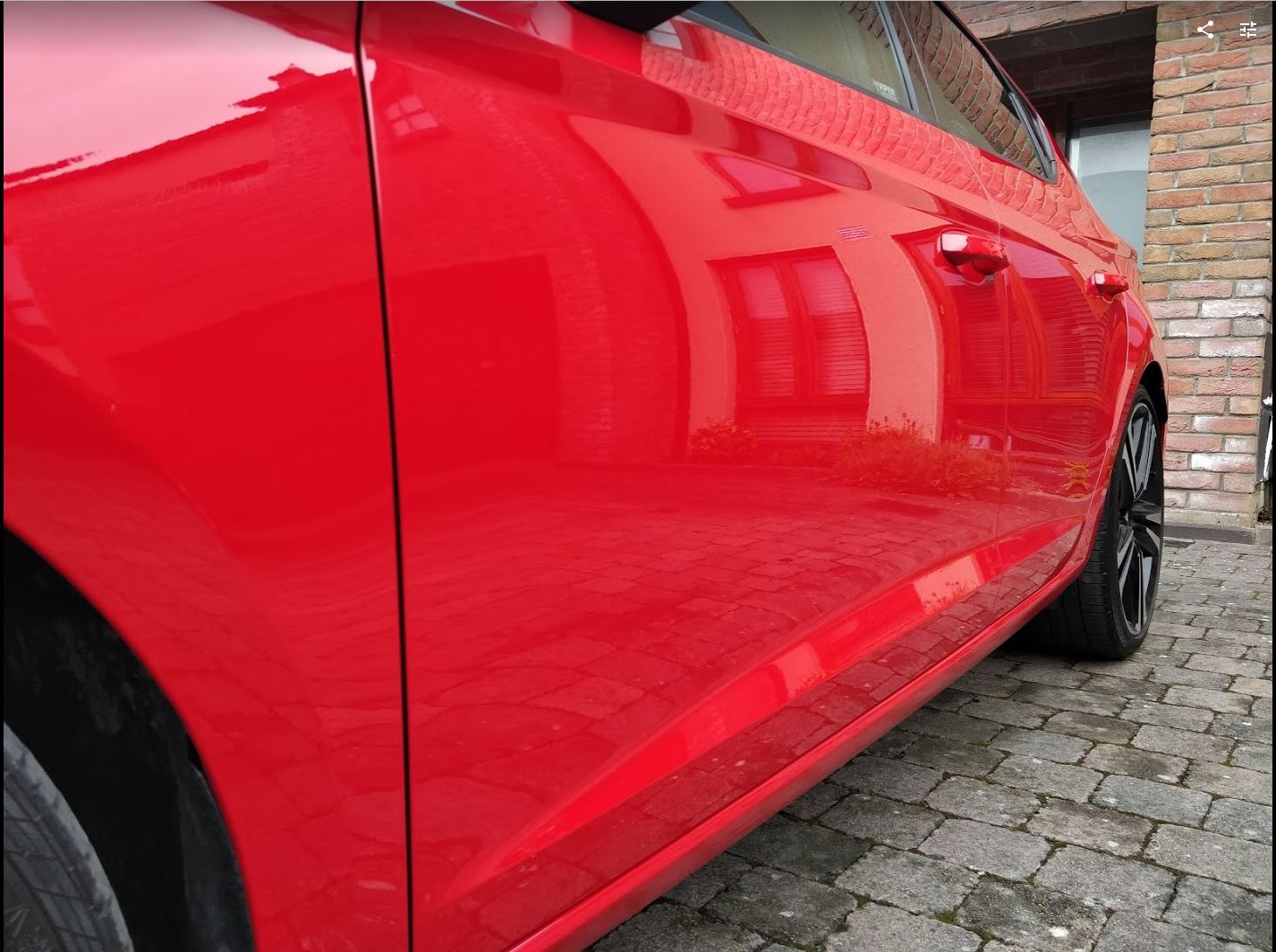

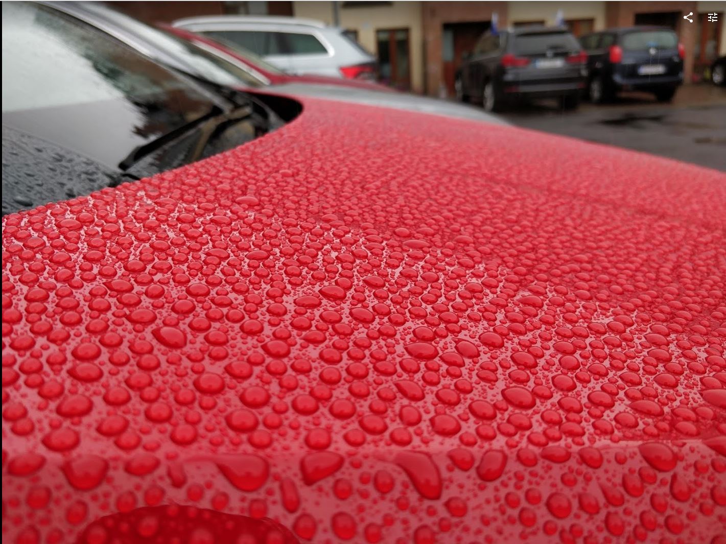

After getting my R brand new, I did a full clean etc in this order using a jet wash and foam lance. Rinse, snow foam, rinse, clay bar, prewash, rinse, wash, rinse, Bilt Hamber double speed wax, Optimim Optiseal. It came out as in the picture below. Might try a different wax in future as the Bilt Hamber was hard work as a hand wax but the Optiseal was extremely easy to use! Pretty much bought everything from Cleanyourcar.co.uk. Good luck!
Dampen your foam applicator and with Bilt Hamber Double Speed Wax a little goes a long, long way.
If you found it difficult to remove, chances are you applied it far too thickly.
I have used it a number of times on a few different cars and have found it to be one of the easiest waxes to remove.
For ease of use, cost, longevity and looks it is definitely one of the best waxes on the market, currently.
