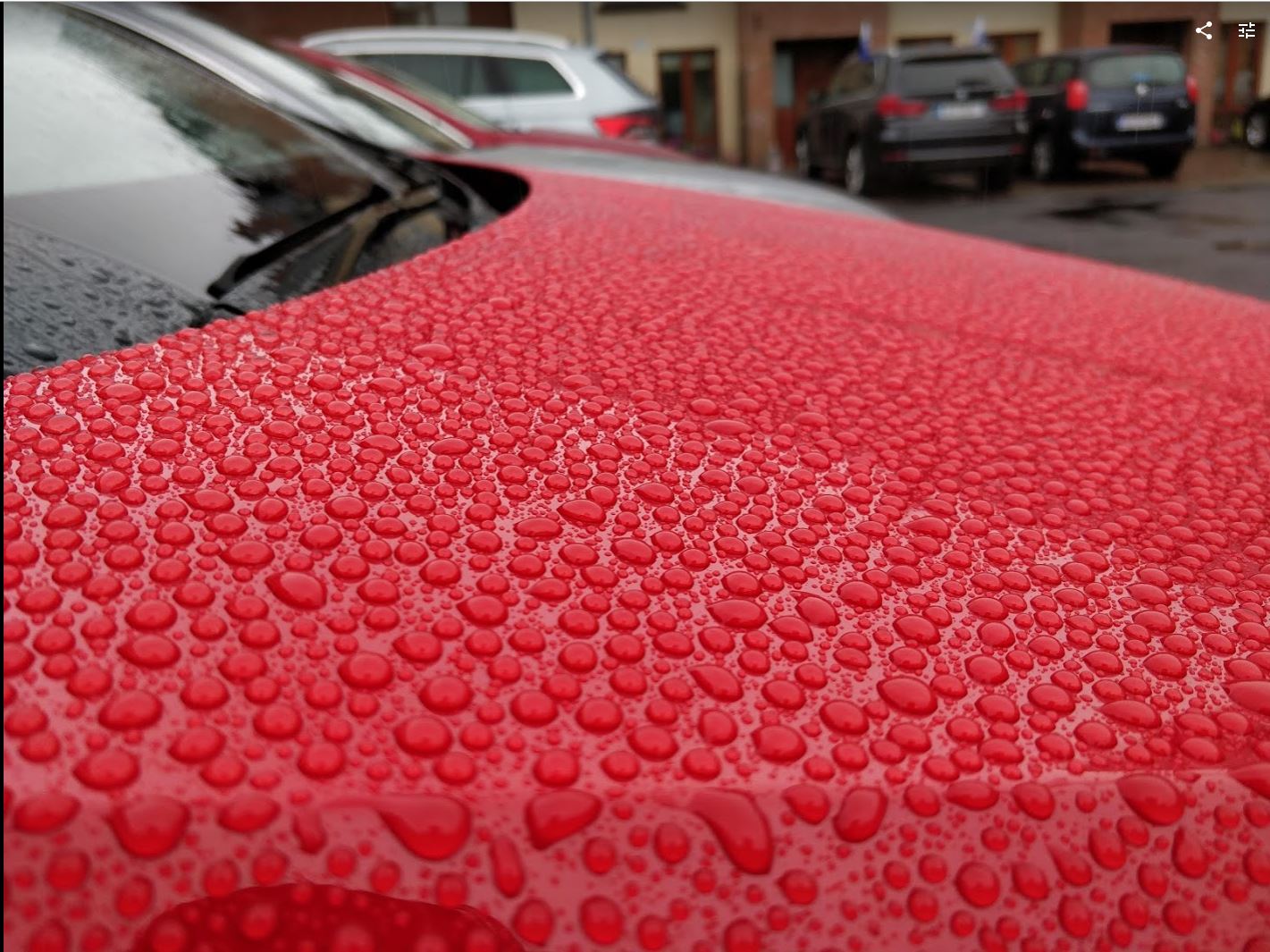

After getting my R brand new, I did a full clean etc in this order using a jet wash and foam lance. Rinse, snow foam, rinse, clay bar, prewash, rinse, wash, rinse, Bilt Hamber double speed wax, Optimim Optiseal. It came out as in the picture below. Might try a different wax in future as the Bilt Hamber was hard work as a hand wax but the Optiseal was extremely easy to use! Pretty much bought everything from Cleanyourcar.co.uk. Good luck!

I use bilt hamber double speed wax too, when I started using it I thought it was hard to apply and take off too, discovered that giving the applicator a wee spray of water makes it easier to pick up the wax from the container, apply it as thinly as possible so you can barely see it on the car then when you take it off it's really easy and it lasts me just over 6 months having clayed and polished it beforehand, as many people say prep is the key to having protevtion lasting longer.
