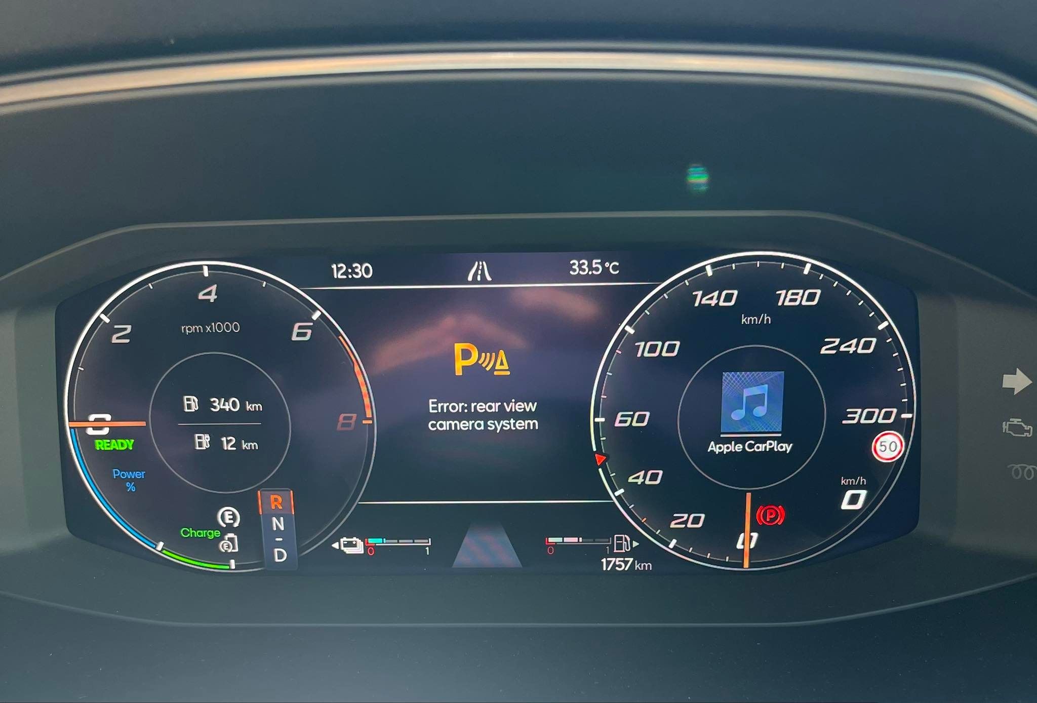

A few days ago, when I started the car and started reversing out of my garage, I got this alert and the screen was only showing the parking sensors, and not the image from the rear-view camera. Since then, the rear-view camera doesn't turn on, and the car displays this error every time I put it in reverse.
I did contact my dealer to have it checked and repaired, but I was wondering if this has occurred to anyone else and whether it could possibly be a silly software bug I can fix on my own?
(TBH I didn't expect things to start breaking down this early, my car only has 1800 km on the clock.. 😬 )

I had this error on the Cupra leon eybrid that I had. The next time I washed it, the camera lens fell out altogether into my hand. Have you checked that the camera lens is still intact and attached? (y)

The lens is intact, not even a single scratch on it..
I will probably wash the car in the next few days, hopefully the lens won't fall apart 😅
But I don't think it will, because the first thing I did after getting this error message was to clean the camera with a wet cloth, and I did apply some pressure to it as well to ensure it was firmly screwed on. I think it would have fallen when I applied pressure to it, if my case was similar to yours..

I had this fault after I did an OTA update, took it too the dealers last Wednesday where they installed version 1898. Now it’s working again

I will ask my dealer to update the software when I take the car to them.
I also installed an OTA update, but that was about a month ago and the camera was working fine until a few days ago.. Did this fault appear to you right after installing the OTA update or after some time?

Yep. Fault happened straight after the updat. Only noticed it when I was parking.

My Formentor has the same thing. And it broke with only 174km on the clock.

Did you get it fixed?
I took mine to my dealership last week. They said it was a software issue, which they supposdely fixed by updating the ECU software (not the infotainment software).
The camera was “fixed” and worked fine the day I picked up the car from the dealership, but literally the next day, the same exact error returned, and the camera didn’t work again ever since, so I will be taking it back to the dealership for a second attempt to have it repaired..

Good luck with that.
Today my camera just started working again.
