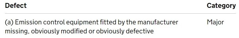

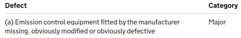

What are you going to do come MOT time, when you fail for having the EGR removed?
Yea, usually they'll be an Eco map on offer, just small tweaks and not loads more power.
Thanks for the reply. It's my understanding that removing an EGR isn't an automatic MOT failure, it's only if emissions are significantly increased. Also, I'm having it blanked rather than removed, I should have made that clearer.
Nope it's a straight fail if it's been tampered with in any way.
The inspection is visual only, so you need to be very clear what is going to be done to it. If it's clear for the MOT inspector to see someone has tampered with it, you won't pass.
That's what blanking plates are for. Just looks like a regular gasket from the outside.
