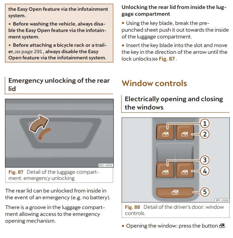

I have a Ctek battery conditioner/trickle charger and a 800A car jump starter (the latter is in the boot of the car)! Together they cost less than 200€.
Of course I can't use either at the moment because I can't open anything bar the drivers door.

The trunk can be accessed by folding the rear seat. Also there should be a lever for mechanically opening the trunk from the inside. I read about it in the instructions.

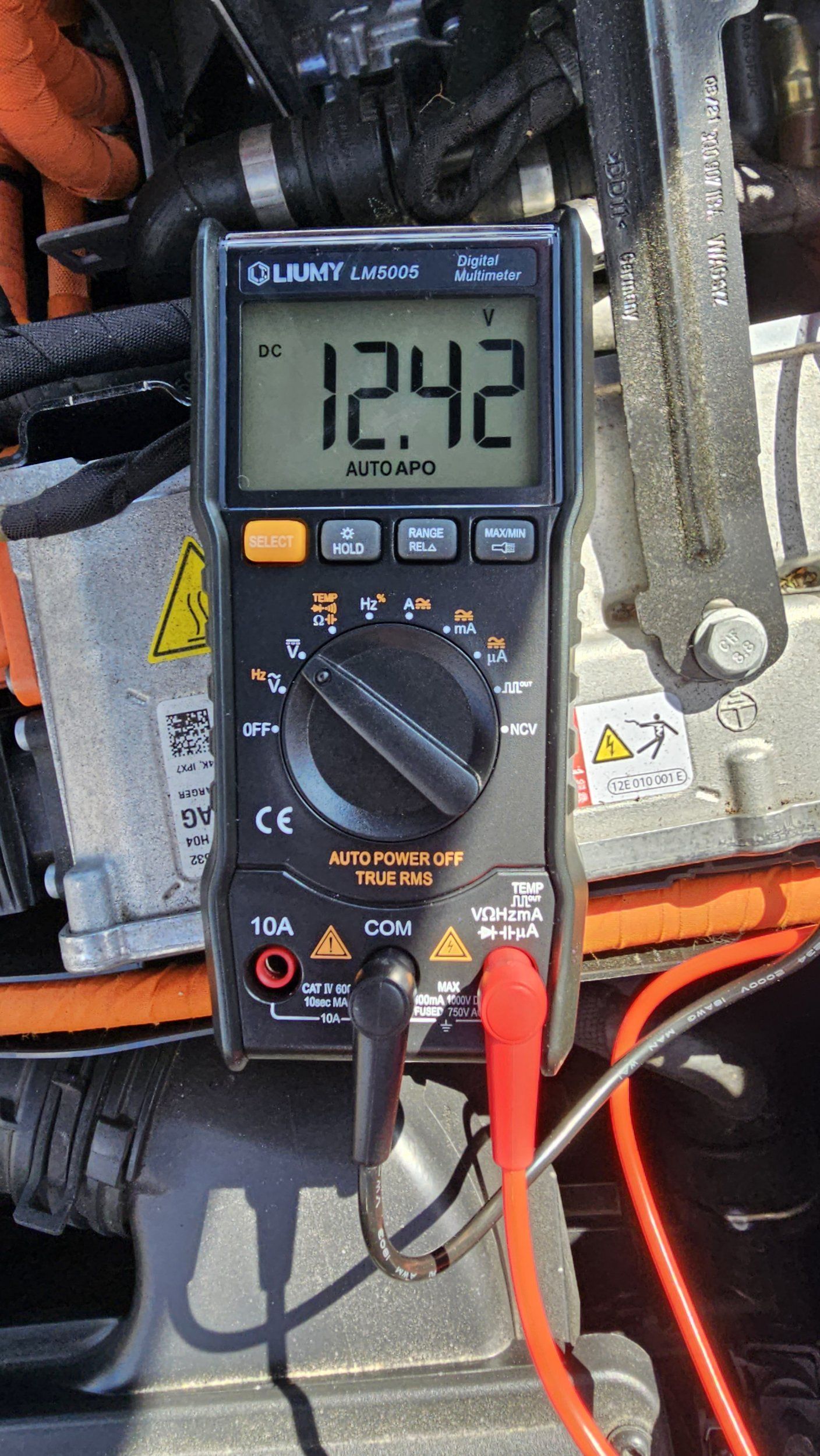

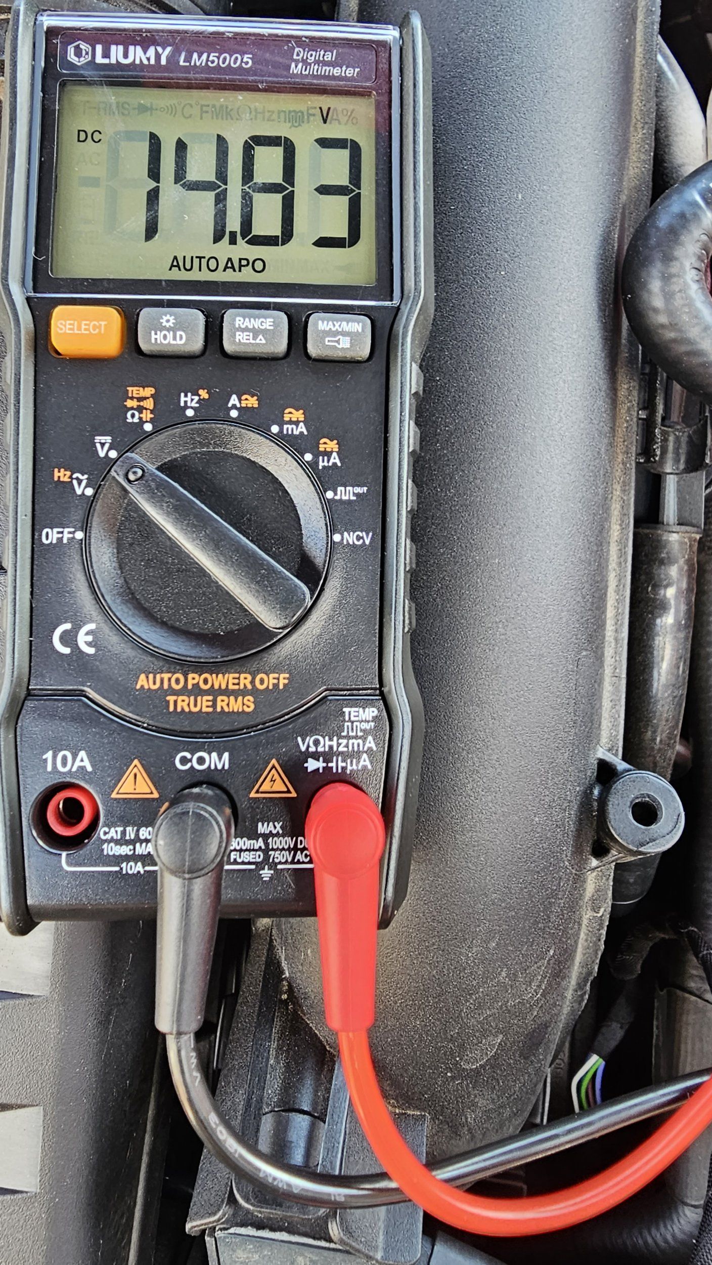

The 12v battery ONLY charges when the fuel engine is running! I have verified this from a few dealers. Therefore, it is important to use a fuel engine in a hybrid car, at least once a week!
I've done some checks this morning and 100% can say that the EV system does indeed charge the 12v battery when in electric mode only. I checked the voltage at the battery and in the engine bay. First pic is with the car off, second pic with the car started but the ICE not running.
View attachment 38130 View attachment 38131
