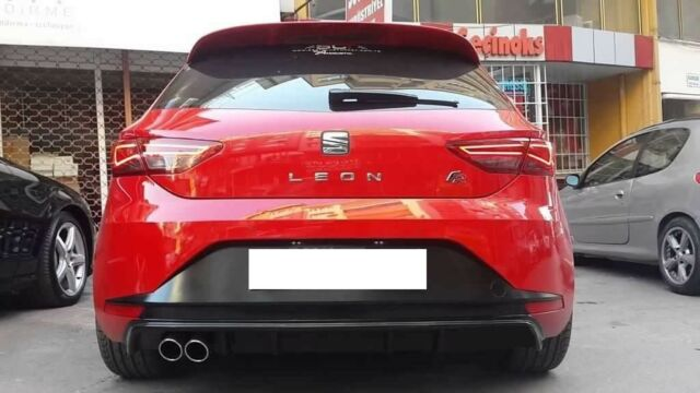

Are you going from the stock FR (dual exhaust single exit) like so:

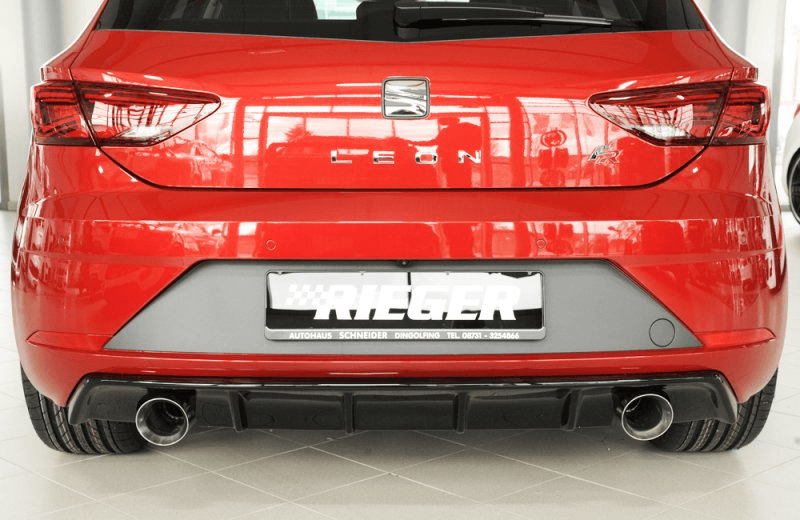

to new diffuser (twin split exhaust)/
I guess it may depend on where the cutout is on the diffuser you would want to install, but if it's meant for the Leon, it should alreayd line up with the respective exhaust system. If I understood correctly, you are also changing the exhaust system from left exist (dual) to twin split exit as per the pics?

Are you going from the stock FR (dual exhaust single exit) like so: View attachment 18228 to new diffuser (twin split exhaust)/ View attachment 18229
Correct, going from the first picture to the second one. Just spoke to a body shop who have said simply removing the current tips in order to fit the diffuser is the best option, that way it is still drivable for the day or two previous to getting the new system installed
