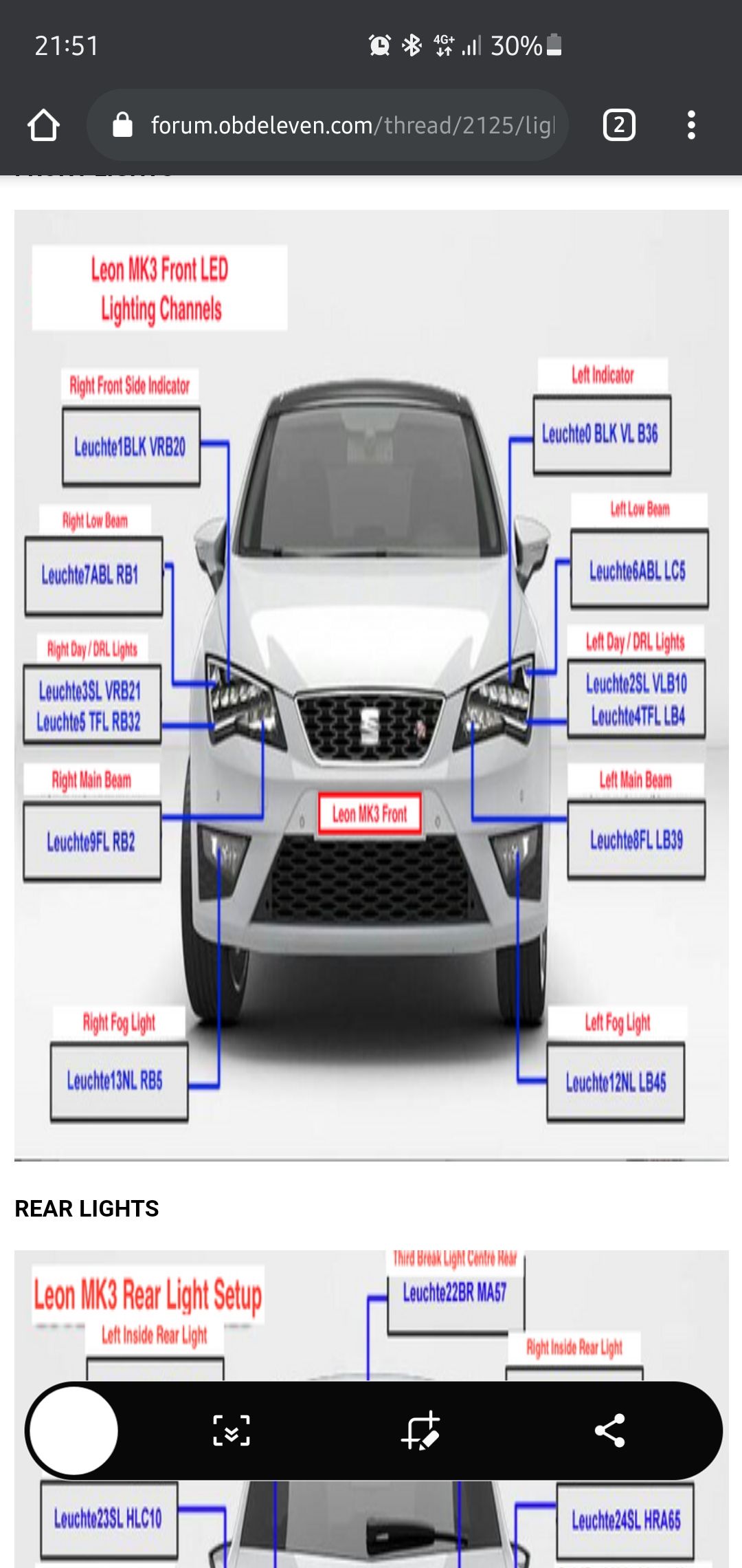

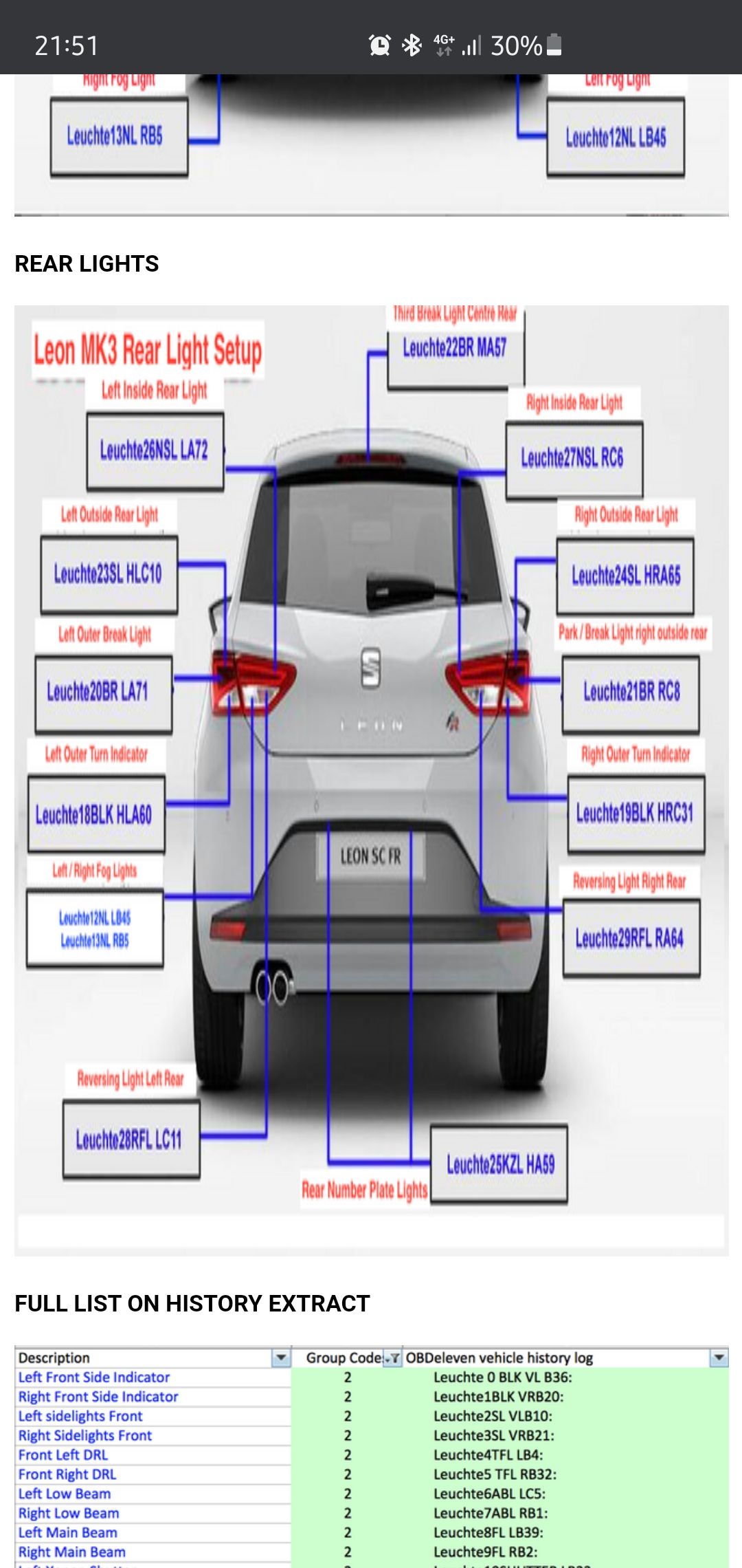

You might retrofit autolights easily, there is a thread about it. And then you can have this feature unlocked.
OR
You can have that without auto lights function. See this Thread.
Good luck
P.s. i have added bulb map so you can mode what ever light you want to activate
