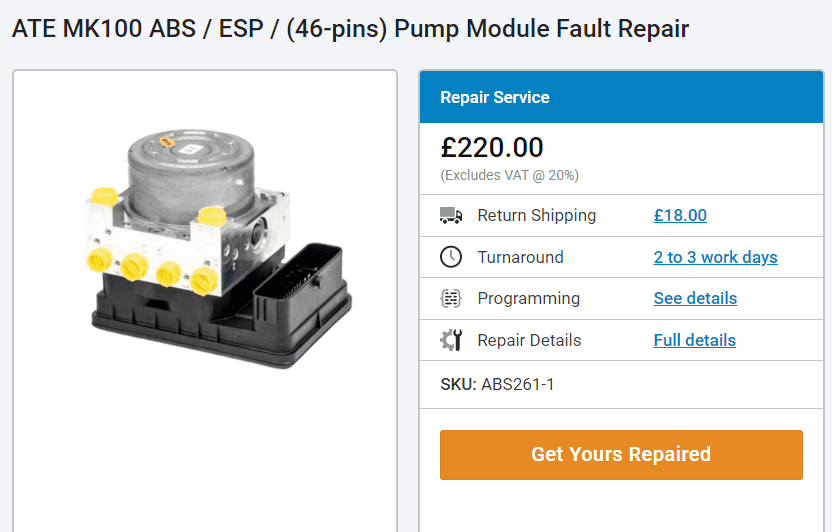

SuperV8
May 30, 2019
1,545
685
This repair kit is just the connector and the circuit board. If there would be any electrical fault, it would have thrown a warning light. I assume since there was no electrical fault, there was a mechanical issue in the hydraulic control unit. The repair service you mention is for a MK60 unit, which is basically the generation found in the Leon MK2, Golf V, maybe even some early Golf VI. The units for the Leon MK3 are MK100's.
Do you think repair could be an option?
