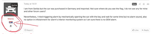

I am from Serbia but the car was purchased in Germany and imported. Not sure where do you see the flag, I do not see any for mine and other forum users?
Nevertheless, I tried triggering alarm by mechanically opening the car with the key and wait for some time but no alarm sound, also no option in infotainment for alarm's interior monitoring system so I am sure there is no OEM alarm.

Your country flag is displayed where indicated below. It’s now showing correctly as Serbia but when I posted earlier it was showing as Boznia and Herzegovina. It’s been acknowledged before on the forum that the correct flag isn’t always displayed - see discussion topic at the link below;
Your investigations seem to confirm that your car doesn’t have an OEM alarm.
